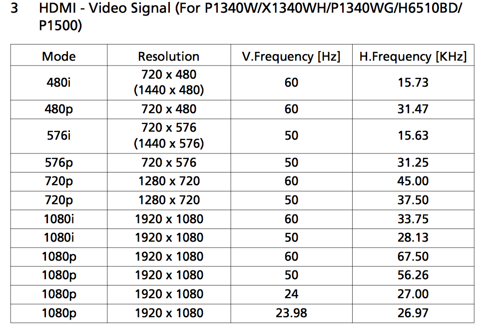

Are you sure your projector supports 23.976Hz and not just 24Hz ?

Straight from the manual
