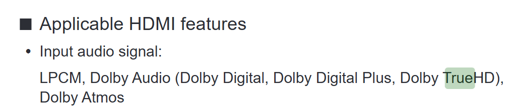

Is the soundbar definitely DTS-HD capable? For example I think some Sonos will will do DTS but not DTS-HD.
The related eHelp documentation does not list any DTS codec as a supported audio input format … ???
Searching the document for the string DTS gives you 0 results.

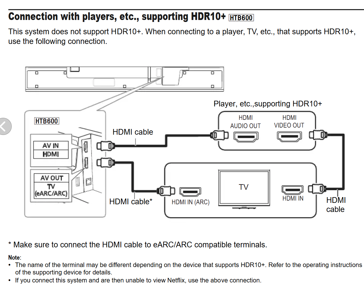

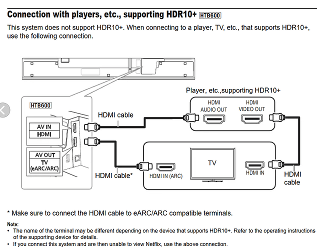

Yeah this does seem to be the case, plugging into the soundbar seems like it will be broken, as it will not support HDR10+, I would have to do something like the below, and use a HDMI output splitter it seems.
If you have any suggestions for a device to deal with this, whilst ensuring Dolby Vision and HDR10+ continue to work, and preserving up to 4K60Hz with Dolby TrueHD or DTS-HD, please let me know!

So, HDMI splitter came today. Tested out DTS-HD MA, all working perfectly. Wired as per the diagram I posted previously. This is a bit of a hack though. When I want to watch DTS content, I now need to use the soundbar remote to switch from TV (eARC) to HDMI. HDMI-CEC based volume control of course does not work though in such a scenario but no big deal.
The next step up would probably be to get a splitter that splits the audio+video into their own respective HDMI outputs, rather than duplicate both to 2 outputs which is what I have now. That might fully deal with me needing to switch between inputs on the soundbar, some of what HDFury sells seem like it MAYBE might work, their boxes which can handle eARC output + video output seem like they might be ideal for my use case, but a tad bit more pricey than my 20GBP splitter :). That or an AVR that can do this.
It seems very strange that your soundbar does not support HDR10+. In order to do this, 2 things are needed:
  • the soundbar needs to pass through the HDR10+ capability of your TV to Vero in the EDID and
  • the soundbar needs to pass through the HDR10+ metadata in a video stream to the TV
Of these, the first can be overcome by telling Vero HDR10+ is indeed supported: Settings->System->Display->Manually set a display’s HDR support->HDR10, HLG and HDR10+. The second might ‘just work’. It does on my old Yamaha. Give it a try.
