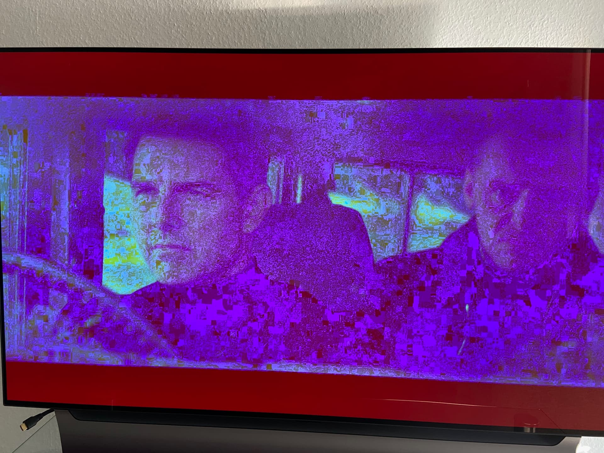

Thanks! The copying of the EDID worked. Also fixed the whitelist. But playing DV files fives red bars and a very purple image. And no DV-indicator.
Display supported HDR Types: HDR10, HLG, Dolby Vision (Std and LL). The AVR does support HDMI 2.0. Can that be the issue? Because you mentioned that DV could be transported over HDMI 1.4.
