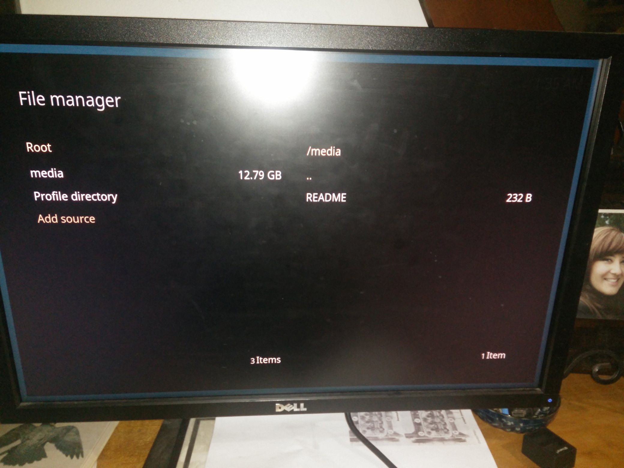

Is there a step by step. I tried File Manager under settings going to root and then media and selecting it… it shows 12.8GB but no files at all. I tried updating the library and going to videos and nothing?

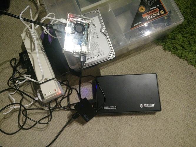

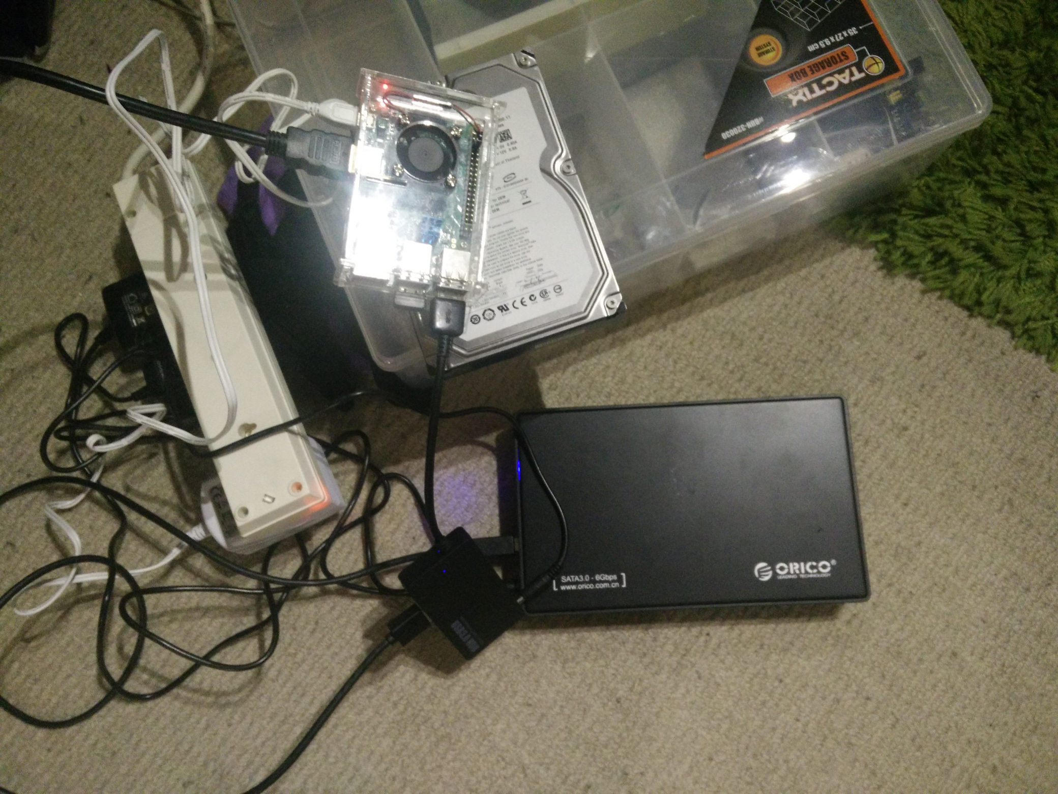

It’s a 3.5" seagate 1tb using a usb 3 powered enclosure and I’ve tried plugging it in to the Pi3 using no powered usb hub or using it through a powered usb hub.
It is formatted via ntfs on windows and files copied on in windows
Sorry I know specifics help! should have mentioned them upfront! I appreciate your replies!

Please see attached. I’ve tried without the powered usb hub… with the hub…
I’ve verified files exist on windows when plugged back in and then safely removed and tried plugging back in?
What is the label? Your drive should appear by its label in the media folder. The path should be /media/drivelabelname.
In your screenshot, it seems the media folder does not have any mounted drives. So perhaps automounting failed at least partly, because of an issue. You should provide logs that will show the mounting failure.
