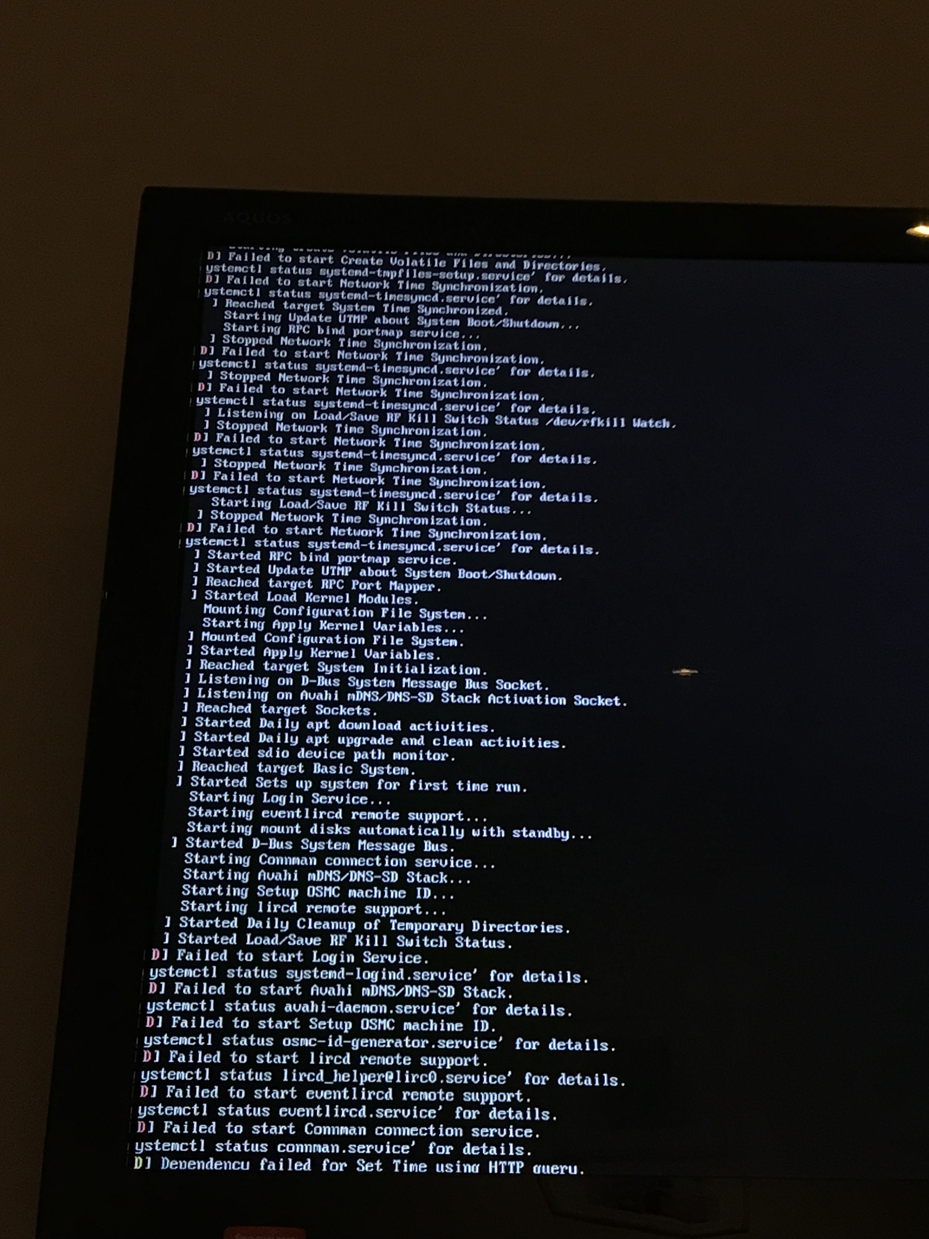

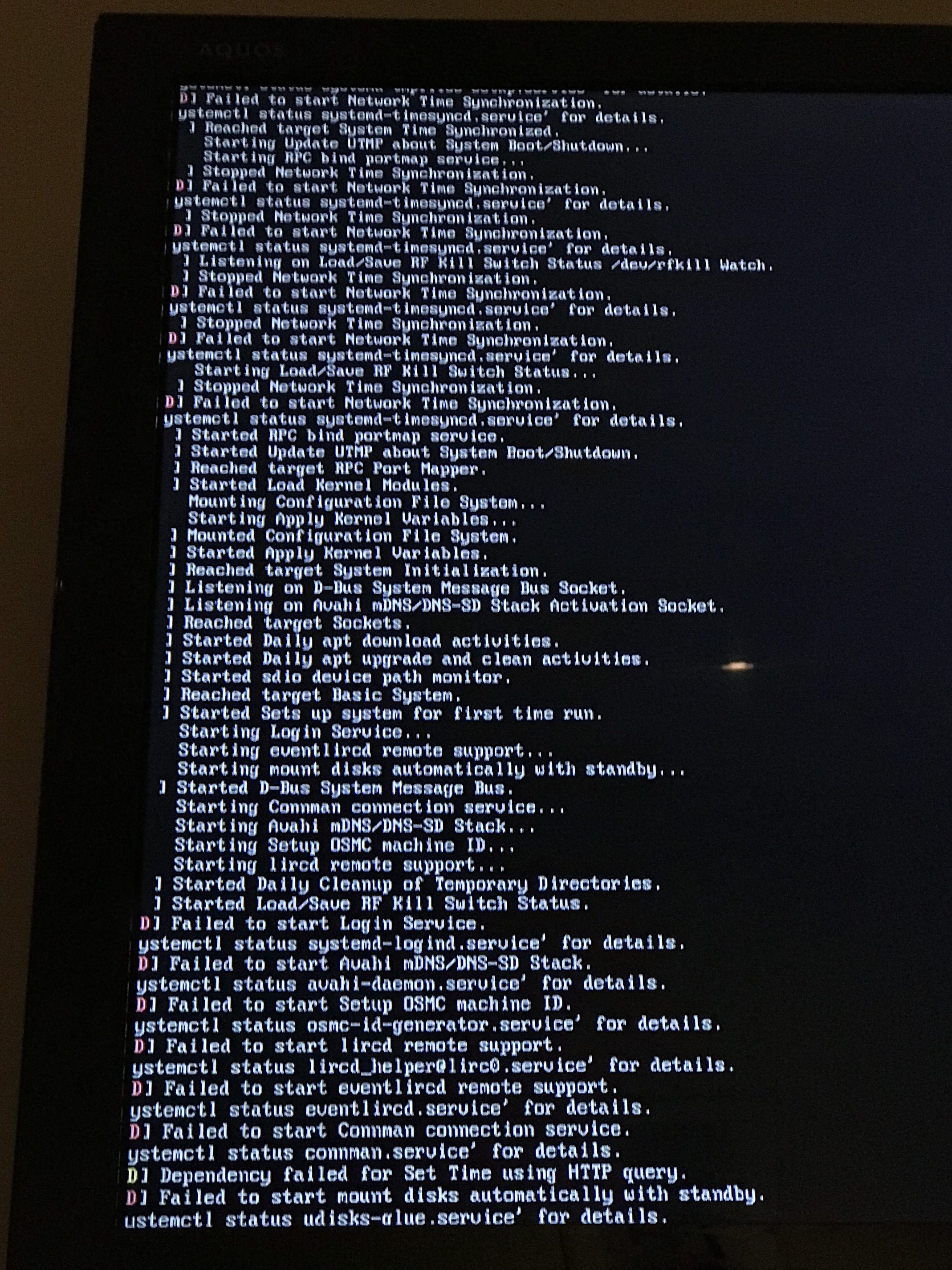

I received my vero today and plugged it in and got the failed to start all only the screen. See screenshots. How do I get this going, this is minutes old. Red light at the start of boot up and that goes out.

Try what @Tom_Doyle suggested but maybe first post your screenshots that we can suggest better.
Screenshots reuploaded
Ok, reinstall may be the right step but maybe also @sam_nazarko want to comment based on your screenshots
Ok, this is brand new out of the box. Nothing modded just connected hdmi, network cable and power,

Me just being stupid, I had the impression that the os was already installed on the built in memory. Anyhow, installed setup on the SD card and installed OSMC. Now up and going

No, it’s not you being stupid. Normally the OS is installed on the built in memory when you receive the box. And it is just finalizing the installation with your local input on first boot.
Which means something went wrong on your box. Maybe @sam_nazarko has a comment but anyhow as you are now up and running I goes all fine.
