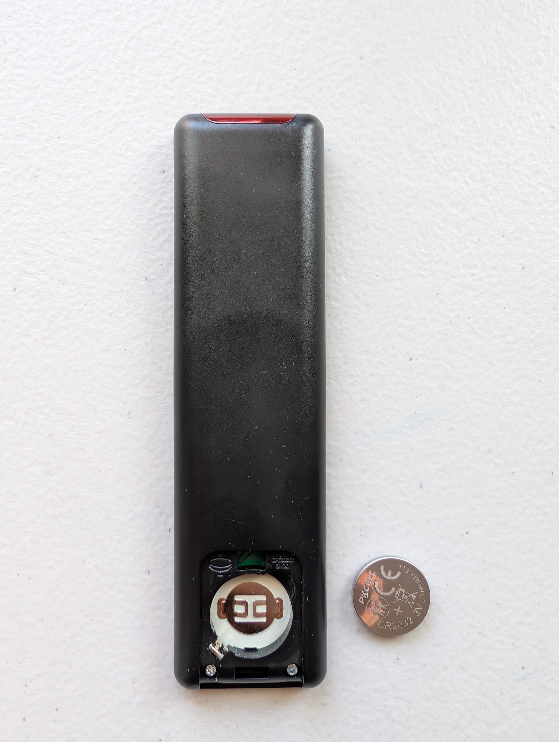

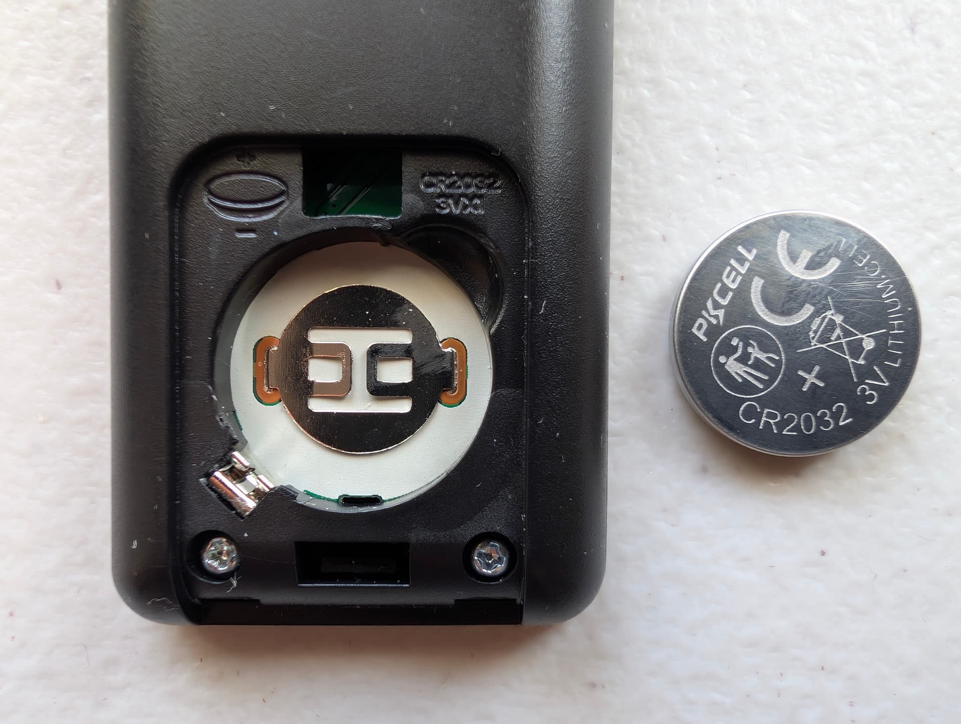

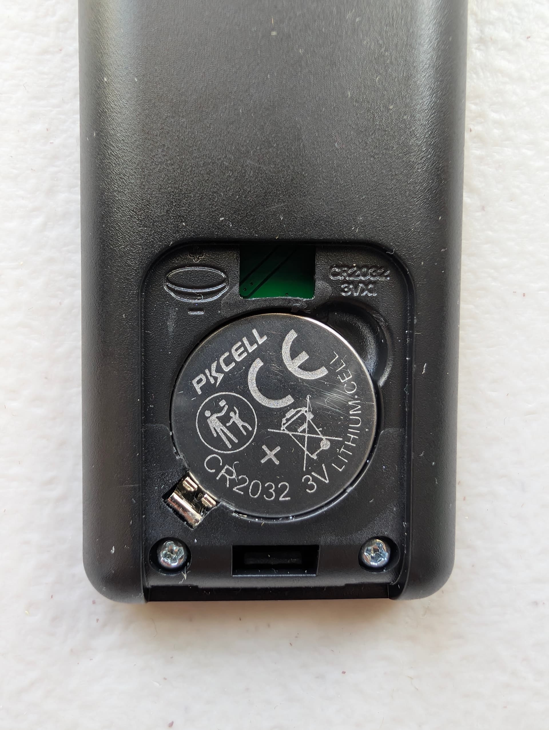

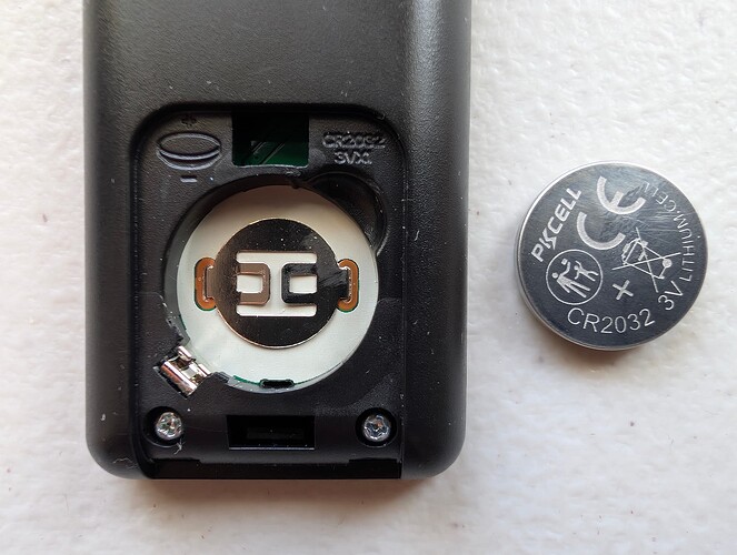

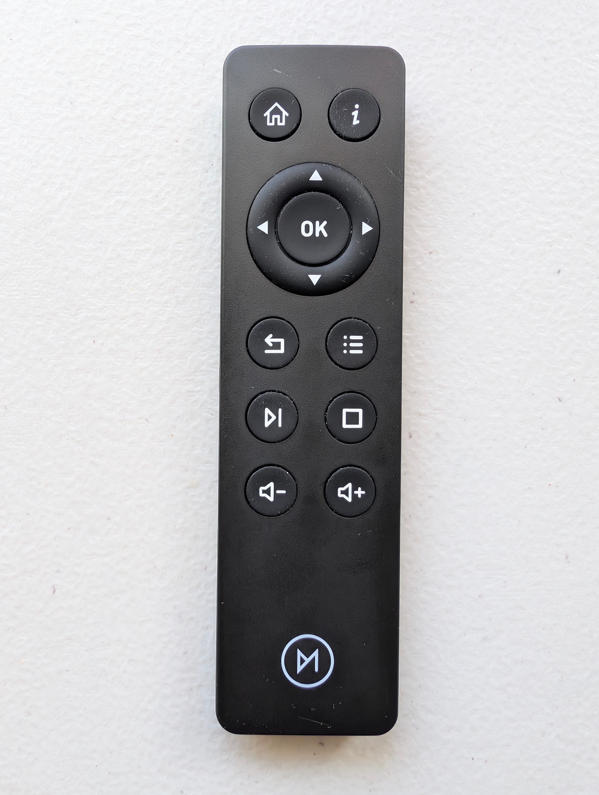

I’m attaching pictures of my remote.
Sorry, I read old remote incorrectly and thought you might be using an older OSMC remote.
It’s on the front window
Are you able to check the voltage (3V) on those? And you did take the label off them, didn’t you? :wink:
You should see the blue LED through the red window at the top of the remote when pressing any key - same side as the Home key.

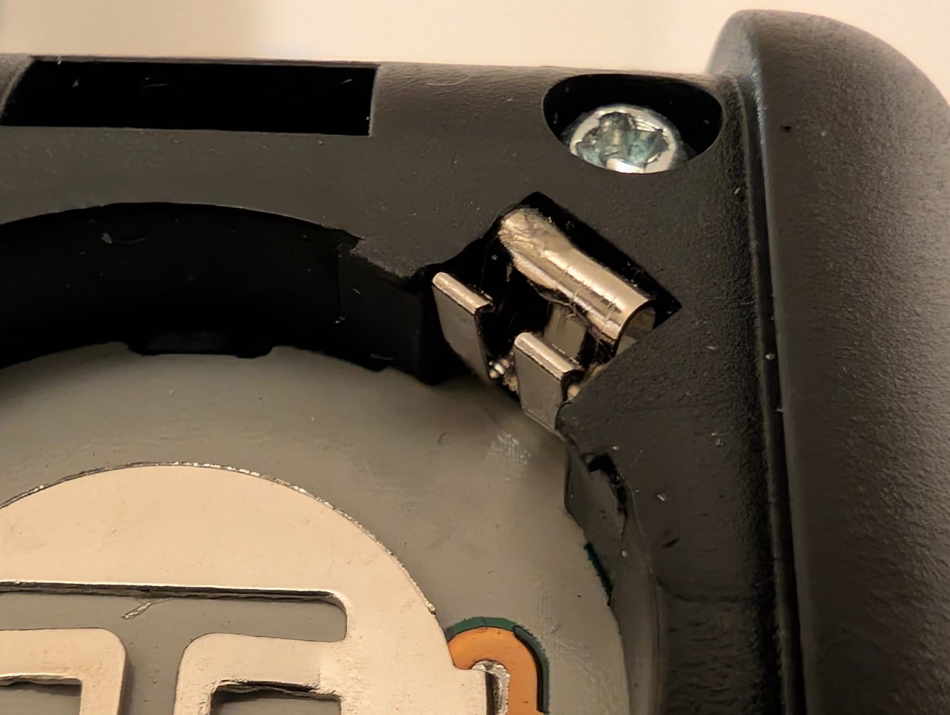

Make sure the battery is clean and spring contact is touching the edge of the battery (+ve) by pushing it with a small screwdriver. If necessary, gently bend it out (further towards the battery).
It works!
The issue was with the metal tips at the edge (see the picture), it looks like they were not getting in contact with the batteries. I pulled them out gently, installed the battery and I finally saw the mythical blue LED (thanks @JimKnopf!)
