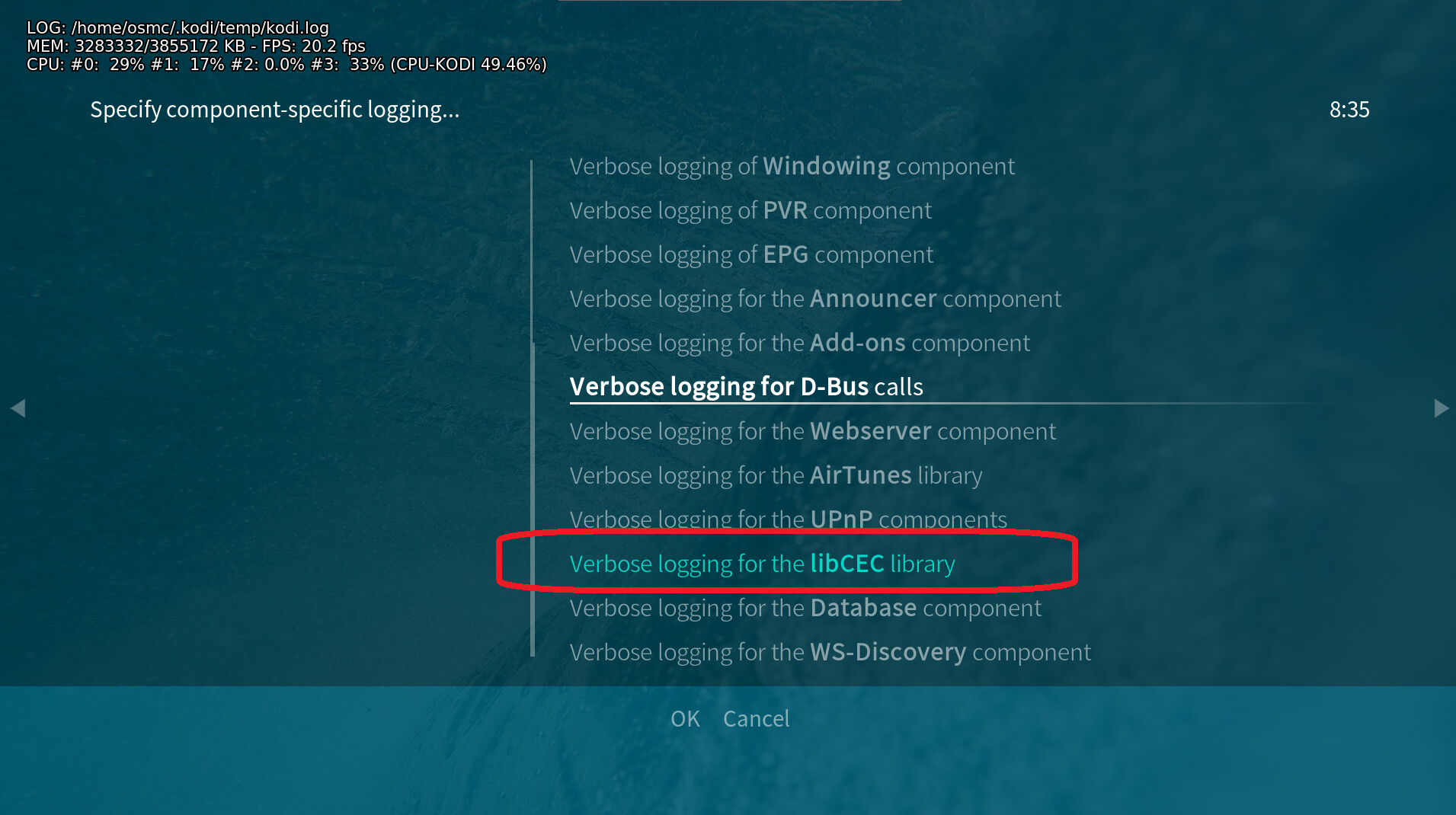

The displayed logs are of little use; more information about the CEC protocol’s activity is needed. For this, a corresponding component protocol can be enabled in Kodi:
  • enable component-specific logging for the libCEC library
  • enable event logging and notification event logging
However, there’s no guarantee that this will help anyone understand the cause of the observed behavior. Theoretically, all devices can see all communication on the shared bus, but debugging is limited to the data provided by libCEC. If certain events/actions aren’t logged, they’re missing from the understanding of what’s happening on the bus.
It’s worth a try, though.
