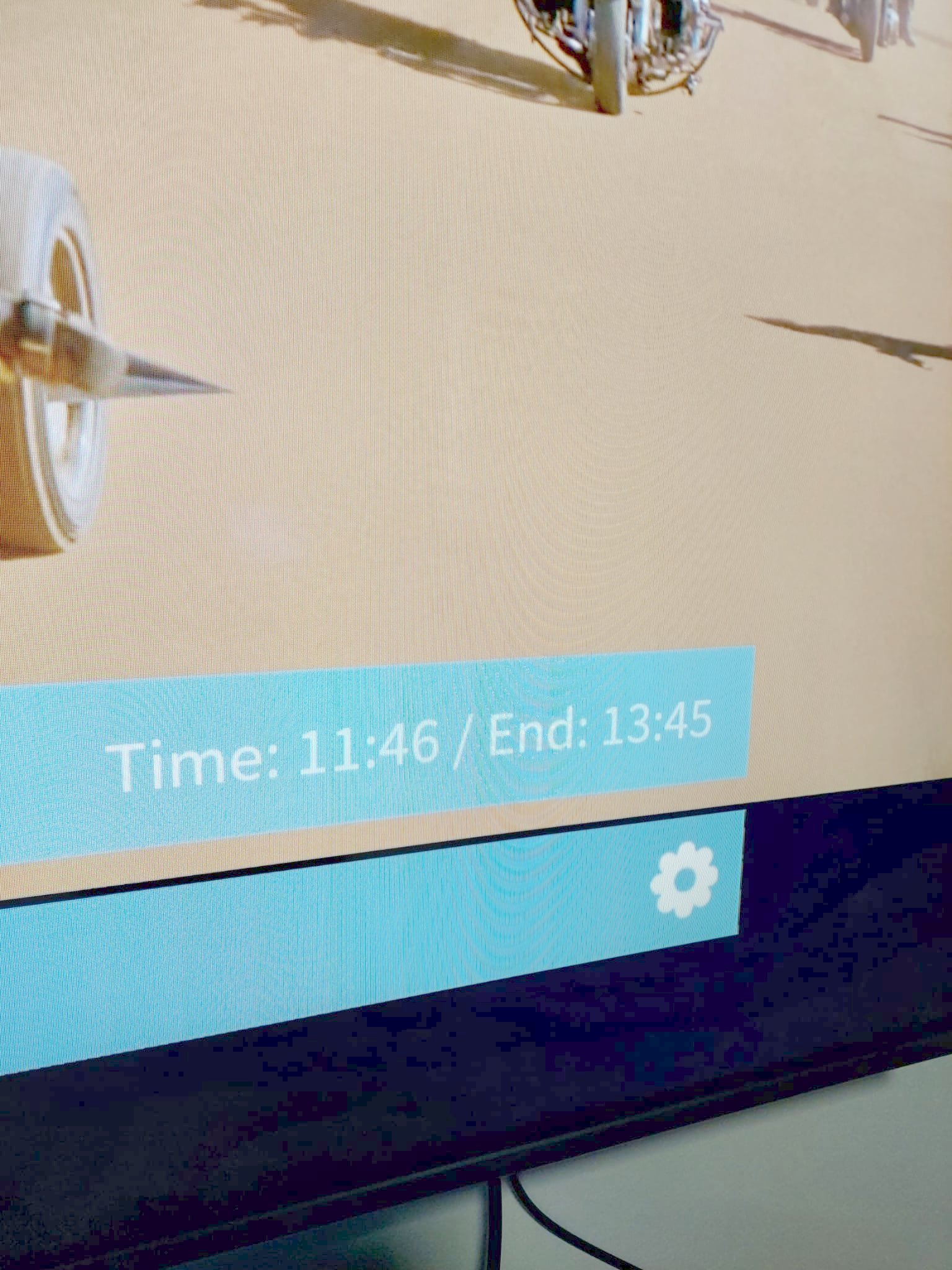

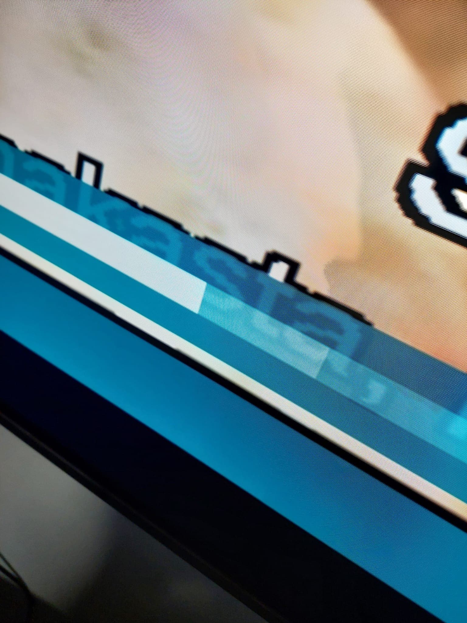

SD and HD video without HDR works fine, however when playing back HDR video the brightness is pumped up for some reason. Easy to see from the OSD colors. However, the video is not washed out and black is black.
Where to look for the culprit?

So when you watch HDR content, is the content itself too bright in your opinion or is it just the OSMC OSD that’s to bright?
You said the video isn’t washed out and the blacks are solid so I’m guessing it’s just the OSD is too bright.
And in the two pictures you shared, is the top HDR and the bottom SDR?
Sorry I may have used wrong terminology.
Yes, the tv is capable of producing high luminance (nits). However, with the brightness problem I mean that if I could take histogram it would be too much on the white side. Washed out would mean that the contrast was low but that is not the case, it’s just too… white/bright?
Yes, top one is HDR and bottom SDR. And the content is relatively as much too bright/white as the OSD is, so the problem applies to the whole screen. Wrong tone mapping / PQ curve could produce this problem I think.
Hope this clarifies :slight_smile:
