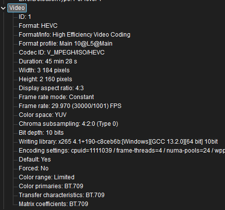

Here’s the MediaInfo data on the DS9 file I’m trying to play:
First time I’ve come across a 4k file with 4:3 aspect ratio. I couldn’t see where to obtain those upscales. Can you point me to that or upload a sample somewhere? Are the other TV rips strange aspect ratios? Grand Tour and Clarkson’s Farm can’t be 4:3, surely?
Agreed. I don’t think The Prisoner has been restored in 4K just yet…
