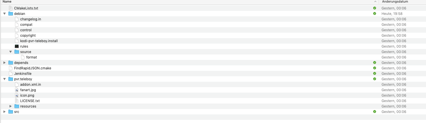

i can try … this would work through cmake i guess?
That’s what it looks like to me. Unfortunately, the developer has no README to help in building it. You might want to contact the developer for instructions, and find out any dependencies needed to successfully build it.
it’s just “cmake ./” in the root directory of the downloaded source i guess …
apparently i have to specify the kodi-plttform though:
~/pvr.teleboy-18.1.6-Leia$ cmake ./

i was able to built it after the developer updated the instructions!
