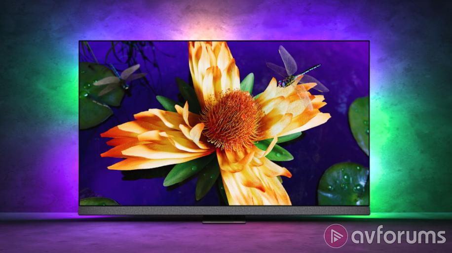

If you were in the UK, I would suggest posting on www.avforums.com for advice; in the US, I would recommend www.avsforum.com . Is there a South African equivalent?
