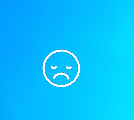

After the Update today (10th Dezember 2023) ingot an Update Error Message and after that the vero crashed and i only get a “blue” screen with sad Smiley.
How can i fix this Problem?

I moved your post to a new thread as we don’t know if it has any relation to where you posted. Would you be able to access your device from the terminal and run “grab-logs -A
” and let us know the url that is returned. Without logs it would be hard to determine what is wrong and be able to provide an alternative to a clean install.
Alternatively you can reinstall OSMC from Download - OSMC if you don’t mind start fresh.

It looks like a update failed. Does running the following fix it up.
sudo apt-get update && sudo apt-get dist-upgrade

This error occurred due to high uptime’s reboot and you should be able to update just fine now
Now my Kodi starts again and it seems everything is working fine. But at the first start i got the error that the “new” update (i forgot to write down the number) wasn´t installed correctly.
