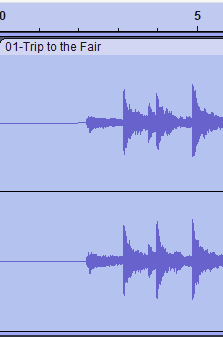

“Trip to the Fair” 16/88200 has silence at the beginning. But it cut out after playing for a few seconds on the Vero V staging release.
