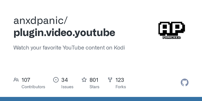

You would need to use the latest version of the addon from github

the new youtube addon 7.2 work finely, many thank
