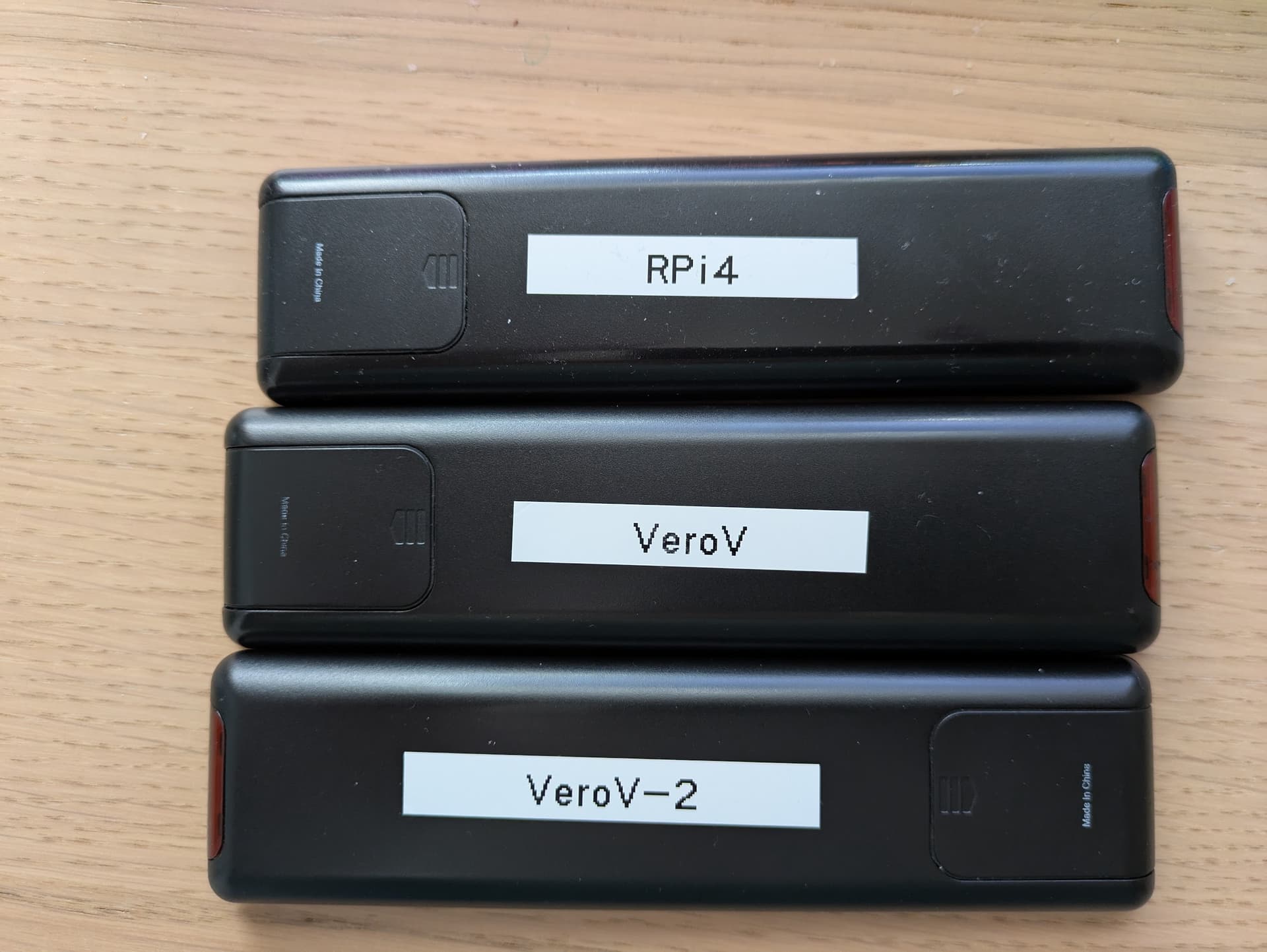

:joy: Everyone has their own method for distinguishing between OSMC remote controls. Here, it is a humble label printer—the kind often found in offices.
