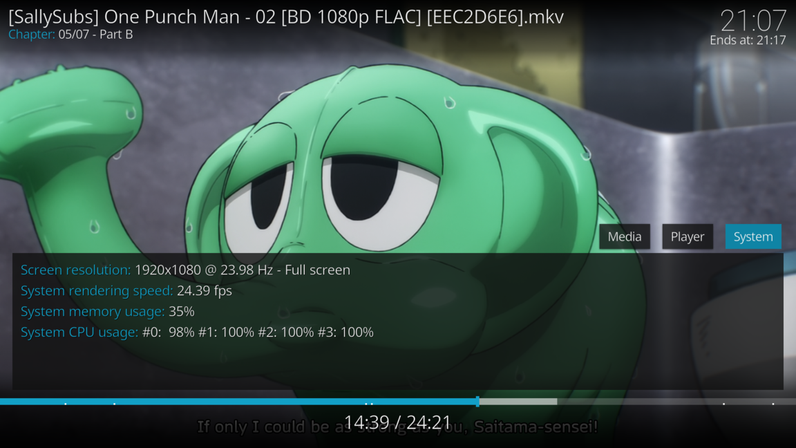

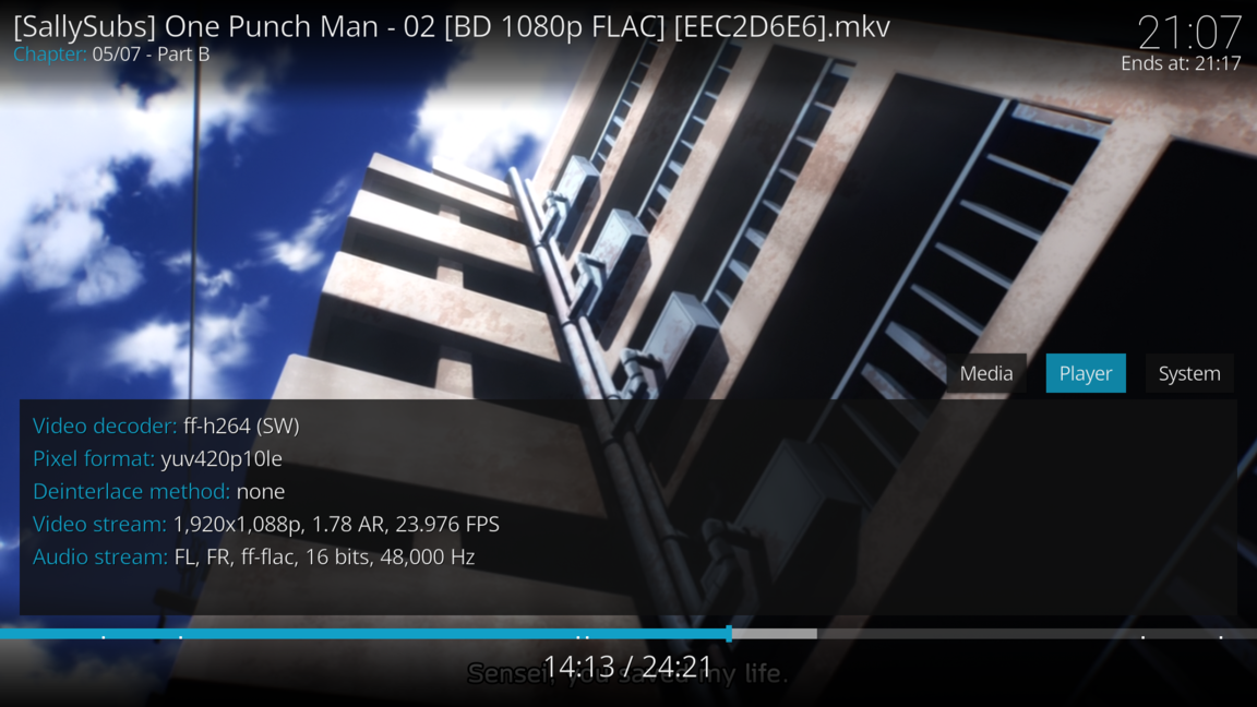

I mean, they are watchable, but you can see that something is wrong, as the playback isn’t smooth, which is how I suspected that they are playing with software decoding. And indeed, they are, because there is SW value on the Video decoder line:
and CPU usage is about 100% on all cores:
Here’s the video file information:
This is the first time in over a year with Vero V when I encounter hardware decoding not being enabled. Everything else have been playing flawlessly.
It probably has to do with the fact that this video has 10 bits color depth? It feels like a well-known problem, but from a (brief) search at the forum I haven’t found a solution. I only vaguely remember reading somewhere that this could be related to Kodi being built with OpenGL ES and not the “desktop” OpenGL, which might be contributing to the problem, but that’s outside of my expertise.

It’s Hi10 (guessing anime), which isn’t supported.
There is no hardware decoder for Hi10, so software decode is unfortunately expected
