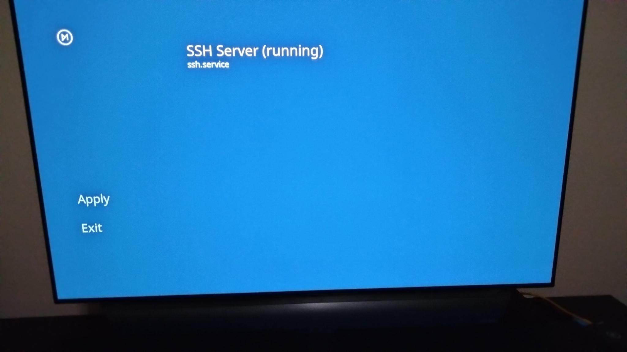

Did some digging around on the V and looking under My OSMC / Services I only see SSH but no SMB.
What am I missing here?

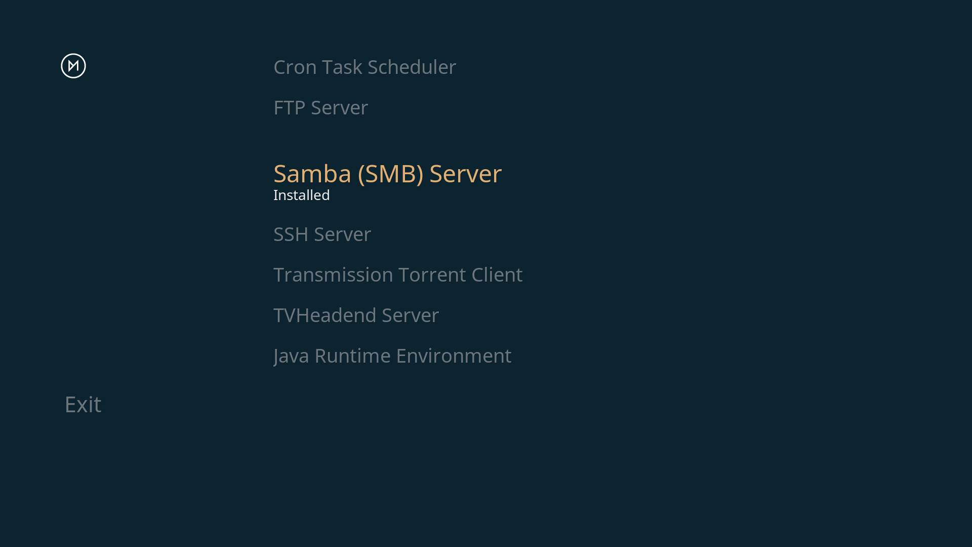

Okay, I went to the app store (shopping cart icon) and installed it again.
Showed up and running in SSH but still couldn’t connect to it.
Did a reboot and now it’s working!
A reboot is sometimes needed for Windows clients to pick it up. I’m not sure why.
