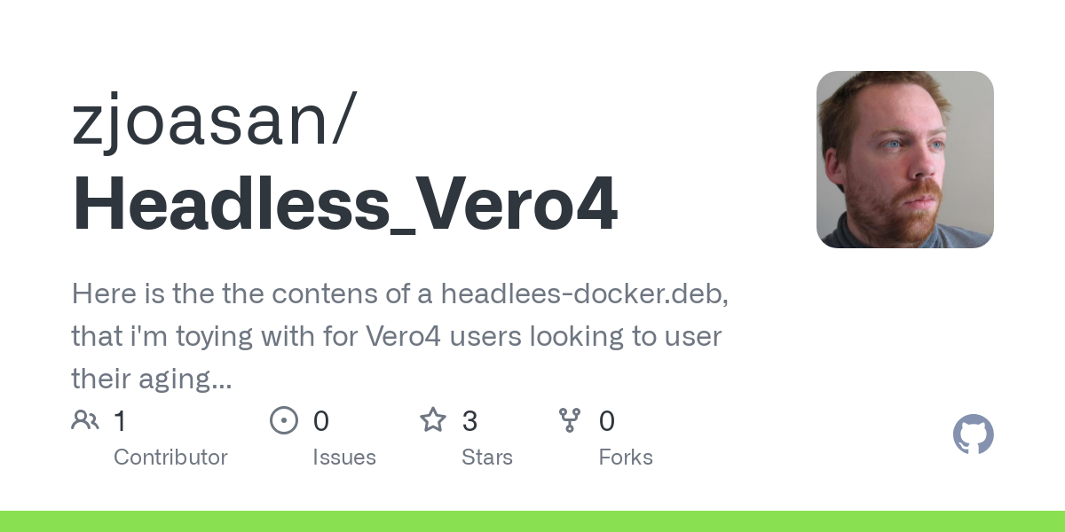

NON-OFFICIAL headless arm64 docker solution for Vero4k(+)
Been using my vero4k as a docker for over 1 year now, and I’ve heard some thoughts about using/repurpose your aging 4k.
I’ve created a .deb package and hosted on github with source, for people to enjoy/alter/pr. This is what it does to your system:
  • Stop and Disables mediacenter from starting again at reboot.
  • Installs fzf, bat, tldr, zoxide, ripgrep, mc, screen and aml-vnc as deb packages
  • lazydocker as binary (version 0.24.1 tested and working)
  • eza as binarys v.0.20.20 tested and working)
  • docker_install.sh (needs to run as sudo, and sets up your vero4 as an arm64 dockerserver)
  • samba_install.sh (install osmc samba that autoshares your automounts, but also downloads a python version of wsdd service, to make sure your vero4 is seen on the windows network. ads osmc smbuser and ask you to provide a password)
.deb and all source can be found at:
Ps. For those that don’t know how to download and install in shell(ssh):
wget https://github.com/zjoasan/Headless_Vero4/raw/refs/heads/main/headless-docker_0.9.2_arm64.deb
sudo dpkg -i ./headless-docker_0.9.2_arm64.deb
sudo docker_install.sh
