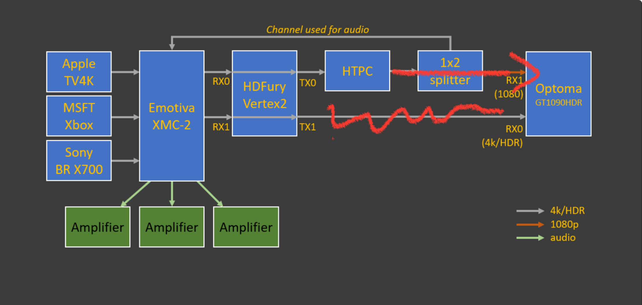

I have connected everything as shown here.

This is complex, some more questions then -
  1. So is the Vero-V connected as an input to the Emotiva XMC-2 ?
  2. Where is the Denon AVR as reported in your EDID ?
  3. ‘channel used for audio’ ? Not sure what this is ? Surely the audio is an output of the XMC-2 to the three amplifiers ?
  4. Why is everything routed via the HTPC ? Wouldn’t it be better to route the output of the HTPC to one of the Emotiva Inputs and just use the 4K/HDR input to the Optoma projector ?
Yes, as an input. But the graphic was an example. I have a Denon AVR 4800.
The HTPC hangs between the Denon and the projector as a video processor. This is a JVC NP5.

Is this your image? Because it doesn’t seem to match the equipment you own which is confusing.

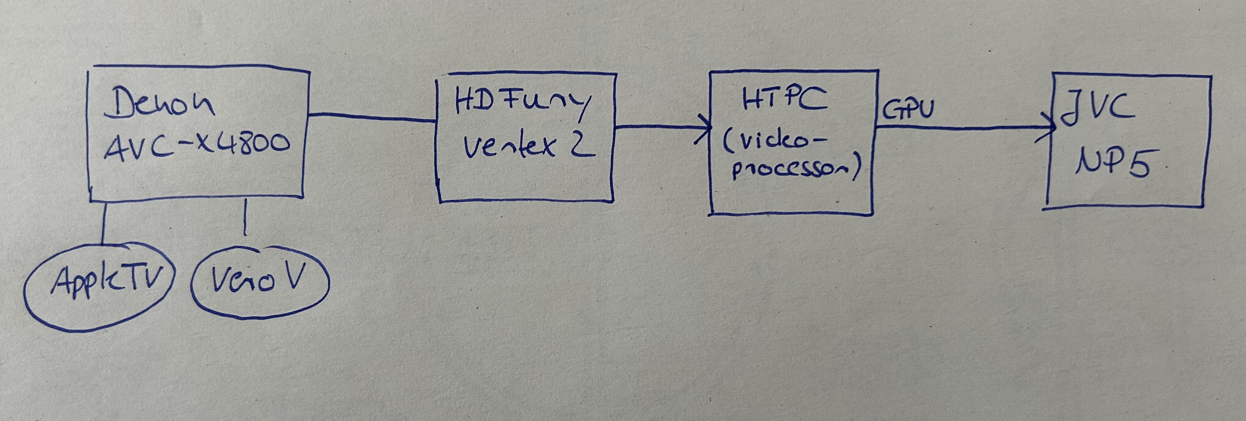

I have sketched the setup by hand. I hope that’s enough for you.
So what is the purpose of the Vertex? Are you using a custom EDID and if so, why?
How does video get into the HTPC? An HDMI capture card perhaps?
