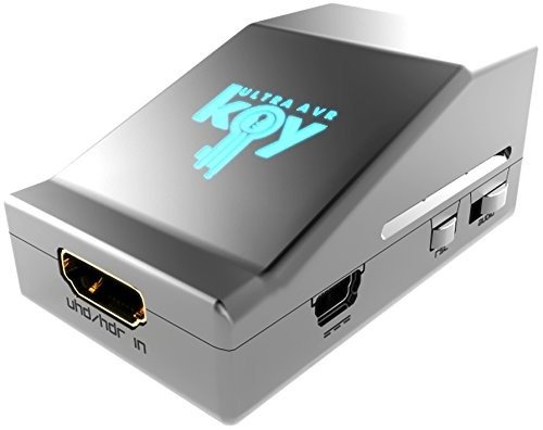

If you don’t want to upgrade just yet an audio extractor might fix your problem. I’ve been using a Hdfury AVR KEY (HDMI 2.0 18Gbps bandwidth only) for the last 6 years, ever since I bought a 4k lg C8 OLED and didn’t want to upgrade my 1080p AV Receiver because the audio was still really good (no atmos as it is rather old).
£125
I’m still using it. At some point I’ll upgrade my receiver, probably when I get a new TV with 4k120 hdmi 2.1 ports and vrr. I was able to watch Gemini Man at 4k60 4:2:2 using this device.
Is there any video content that this device is not capable of handling? If so, are there alternatives that support those?
It can’t handle anything with a hdmi bitrate over 18Gbps or features only present in the hdmi 2.1 spec.
NB, that this list says hdmi 2.0 doesn’t support dynamic hdr when it does is because support was shoehorned in as a hack i.e. dolby vision is sent wrapped in an rgb 4:4:4 stream.
I haven’t tried anything else because my TV also only has hdmi 2.0 ports so 18Gbps is my limit. I have looked into it a bit and the HDFury products designed for hdmi 2.1 and 48Gbps such as the Hdfury Vrroom 8K are a lot more expensive, as in you might as well put the £450 towards a new receiver.

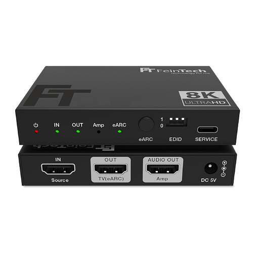

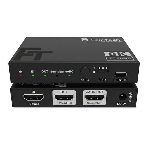

It’s been a while since I looked and it looks like you are in luck, Feintech launched a reasonably priced device in September 2024 (according to amazon.be)
https://www.amazon.com.be/-/en/FeinTech-AX310-Extractor-Soundbar-Supports/dp/B0DHXH5H84
€99 is a steal and if you can get it I’d recommend it over the HDFury AVR KEY any day. Set the dip switches to 111 (copy on both hdmi outputs) and it ought to just work.

Regarding the extractor, how would I set it up? Currently my setup is as follows:
TV (HDMI IN 2 /w eARC) ↔ AVR (HDMI OUT /w ARC) ↔ HDMI IN (1-7) ↔ Vero, Apple TV, Fire TV stick.
As the TV has one port with eARC support, which is port 2, I think I should still connect port 2 of the TV to the AVR, so I can transmit audio from the TV itself to the AVR using ARC. The AVR only supports regular ARC. Also, I still need to be able to use the other devices connected to the AVR. Now, the Vero should be connected to the extractor HDMI IN and the extractor’s HDMI OUT (video) to e.g. port 1 of my TV and the extractor’s HDMI OUT (audio) to one of the HDMI IN ports of the AVR.
But would this work, if I’d watch content on the Vero and select port 1 of my TV and set the AVR to whatever input the extractor is connected to?
What I am trying to figure out is if this setup is only recommended if the Vero is the only device I want to connect to the AVR, meaning the TV is not additionally connected directly to the AVR but instead solely through the extractor. If so, that does not fit my needs as I’m using at least 2 other players besides the Vero.
As I read the extractor’s description I kinda get the feeling that it’s only suitable when connecting the extractor’s HDMI OUT (audio) port to the HDMI OUT (ARC) port of the AVR but not with one of the several HDMI IN ports of the AVR.
On further reading I think that I need the AX211 for my setup.
Or maybe the SW411 is the one I’m looking for.

You’re right the AX211 would be the better choice, but only because the extra functionality of the AX310 wouldn’t be needed with how you’d use it (plug the eARC OUT into one of your AVR hdmi inputs) so you might as well save yourself €10.
Exactly as this. It’s how my audio extractor is set up.
Yes it would, that is what I do.
