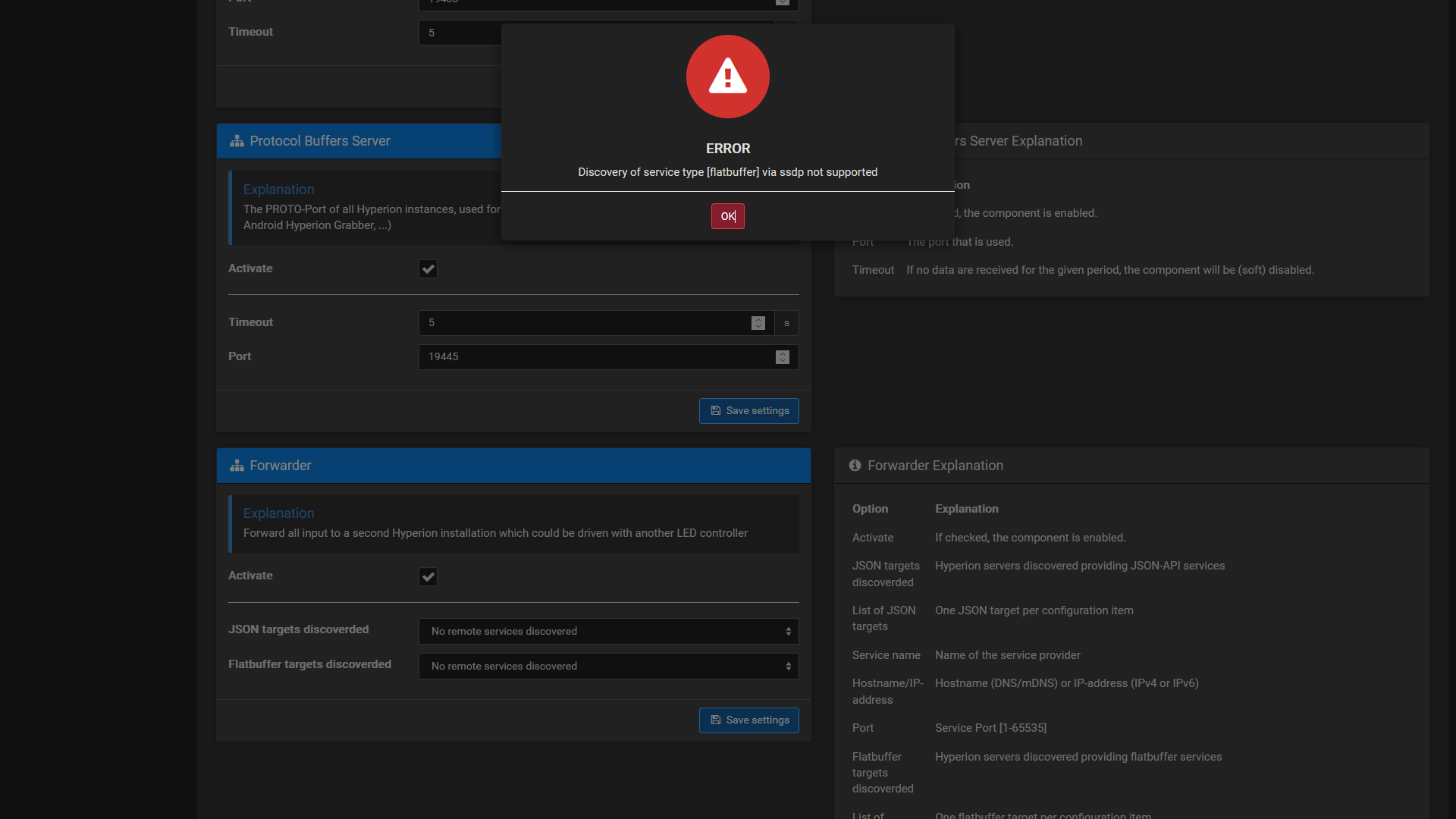

Hello Everyone!
First of all, thank you for this thread and all the input here, with the help of everything here I managed to install HyperionNG on my Vero 4k+ :wink: I would like to ask for some help because there is something I have not managed to solve.
So I have the Vero 4k+ with Hyperion installed. I have WS2812B LEDs installed on the back of my TV controlled by WLED (on an ESP8266). It works fine, Hyperion gets the data it needs from the Vero, sends it to WLED and my LEDs work. I wanted to complicate things and installed the Android grabber on my TV (Bravia Android TV). The Android grabber found Hyperion but I did not manage to get the lights work with that setup so I installed Hyperion on an Rpi 3+. I works, gets data from the grabber and LEDs work.
I thought why not have only one Hyperion sending data to WLED and found the forwarder functionality in Hyperion. That is where problems began. When I enable forwarder in Hyperion on the Vero I get an error message saying 'Discovery of service type [flatbuffer] via ssdp not supported. the other problem is that I cannot even change the value of the two fields where Hyperion says that no services were discovered. I thought it was a problem with the Hyperion I installed on the Vero and tried forwarder on the Pi as well. The result is almost the same: there is no error message but I cannot change the no services discovered part there either.
Could you please help me to be able to get the forwarder working on the Vero or let me know whether it is even possible to get it working?
Thank you very much for all the replies and help!

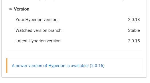

Hmm. I don’t seem to be able to update to 2.0.15. What am I doing wrong?
I issued these commands:
cd hyperion-vero4k
sudo systemctl stop hyperion.service
git clone https://github.com/hissingshark/hyperion-vero4k.git
sudo ./install.sh
Installed from binary, then
sudo systemctl start hyperion.service
Cleared my browser cache but it is still showing:
Screenshot 2023-07-08 at 14-53-24 Hyperion - Web Configuration
That is odd. The installer and pre-built binaries were updated to 2.0.15 in February 2023.
I’ll have a look.
Hang on. If those are literally the commands you used, then you would have to had an existing copy of the repo, which you first entered:
cd hyperion-vero4k
So you then re-cloned a new version of the repo inside the old one:
But you didn’t go into that new nested folder before running the installer.
So you ran the old installer inside the parent folder…
sudo ./install.sh
You need to delete the original, start again, and run the installer it contains. I mean you could go into the nested repo and then run it in there, but that’s just getting multiverse and I hate to think what will happen next time around.
sudo rm -r hyperion-vero4k
cd hyperion-vero4k
sudo ./install.sh
Ah. That makes sense. Thanks.
Any way to keep my settings before deleting?
Could I just delete the nested repo?
No need to keep the repo. Your settings are stored elsewhere
In fact, when they’ve made a major revision we’ve actually had to go and find them and delete them due to incompatibility.
