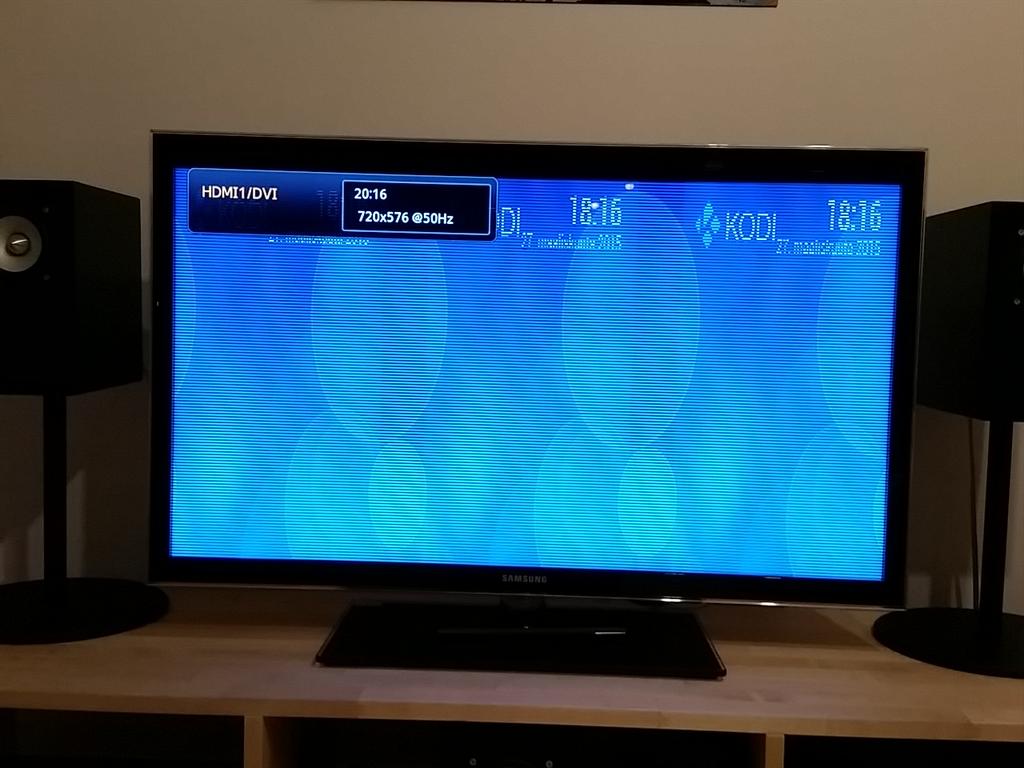

I have always used Raspbmc so that I never shut down the machine. I just turn TV/amp off and then back on when I want to watch something. With raspbmc it took couple off minutes to get the signal from RPi (Model B). But now with Vero and OSMC it finds signal fast, but the resolution is 720x576@50Hz instead of 1920x1080@60Hz that I have defined in the settings. And the screen looks like this: https://pbs.twimg.com/media/CBH6QAfVAAAQKAg.jpg:large
It doesn’t even help to reboot. the signal is either the same of no signal at all. I haven’t yet figured out what makes the signal work again, but shutting down Vero, TV and amp in random order usually fixes it at some point.
