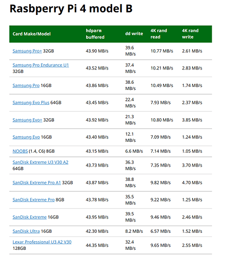

It might be my sd card too? I don’t want to buy from the osmc store due to import charges on delivery outside the UK. I’m thinking of getting a Samsung EVO Plus sd card since apparently the random 4k read speed is important. Is the random 4k write speed not so important? I’m wondering if the Sandisk Extreme Pro A1 would be better on the Pi 4? some benchmarks here:

I’m surprised at how well everything works just because of changing the SD card. I guess the other SD card I used is junk. It’s a Sandisk Ultra 32GB U1, A1 Class 10. Maybe it’s a fake? Well I’m glad I followed the link above to see what SD cards I should be using. Apparently the 4K random read value is most important. I’d be grateful if someone could confirm if 4K random write is important?

I’ve spend a few hours reading up about this stuff and apparently it’s not just the Class 10 you need to look for but also the 4k random read and write numbers.
Jeff Geerling makes SD Card speed benchmarks and in this Github he lists the methods and tools (e.g: iozone) to test sd card performance and how to select one that could make a big difference if you are running OSMC/Kodi on a Pi. SD Cards best suited to a Pi are not always the most expensive either.

My understanding is that when you are navigating the OSMC GUI on your TV and asking it to do things with your attached media that causes a lot of random reads in the Operating System on the sd card in order to co-ordinate with your externally attached media. If your card does those random reads and writes slowly then your experience in the GUI will be painful. And at worst it will crash. I had all that with the Sandisk.
I went to the trouble of running Jeff Geerlings sd card benchmark script on my Samsung EVO Plus 32GB and on the Sandisk Ultra 32GB I had. More information here.
Samsung Evo Plus 32GB
hdparm buffered: 43.33 MB/s
dd write: 20.43 MB/s
4k rand read: 10.61 MB/s
4k rand write: 2.58 MB/s
Sandisk Ultra 32GB
hdparm buffered: 15.97 MB/s
dd write: 2.3 MB/s
4k rand read: 7.5 MB/s
4k rand write: 0.0029 MB/s
The Samsung numbers are an average of three runs. The Sandisk took > 7 hours so I only did it once!
After all that I ran f3probe on the Sandisk and it told me it is damaged!
I won’t buy another sd card without googling for its benchmarks first. I notice that OSMC don’t publish any benchmarks about its own SD card. We’re just meant to trust them I suppose…
