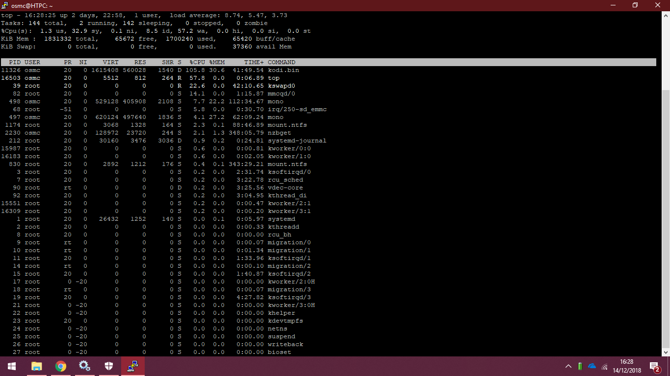

Looking via top, I can see that mono spikes to 20+% frequently - is this normal?
Also , no swap space is being used - is this by design?
Right , it just spiked now massively and it seems kodi is the culprit - see attached
What should I do?
Kodi.bin is using 30.6% of the physical RAM but you also have two mono processes that, when combined, are using 49.4% of the available RAM – so you’ve reached 80% of RAM for just three processes.
A quick check indicates that sonarr and radarr both use mono, so I guess that’s why we see two instances of mono running.
