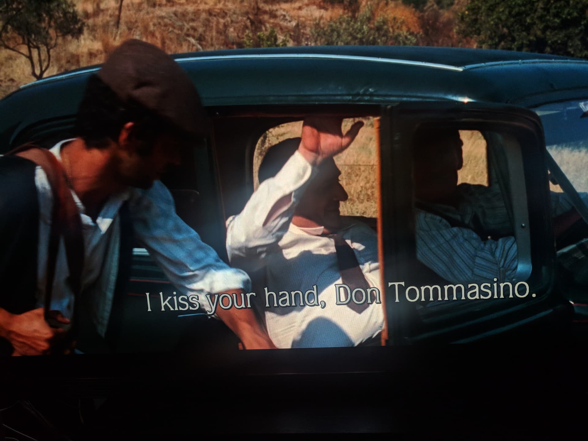

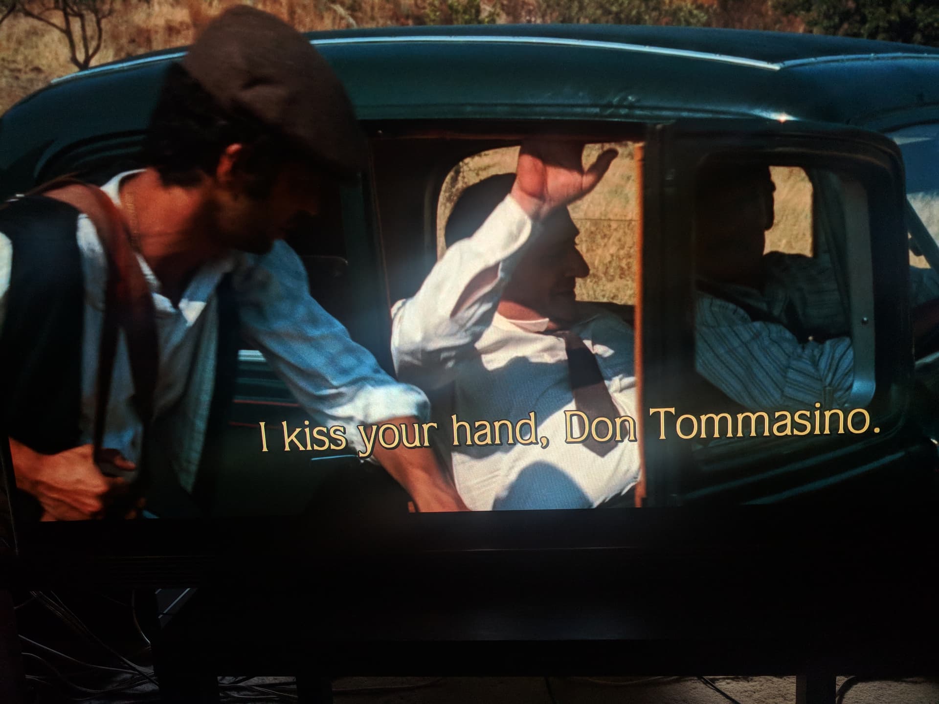

The camera exposure settings and white balance in these two photos won’t be the same, but even so the effect is quite visible…
Oppo:
Vero 4K+:
Indeed, that’s the puzzling bit.

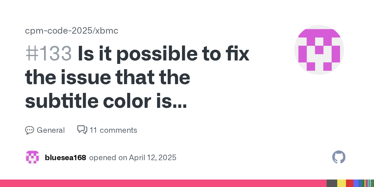

Finally we may some day see a fix for this issue in Kodi where PGS subtitles aren’t processed correctly in HDR.
Hopefully it will eventually find its way to the official Kodi builds.

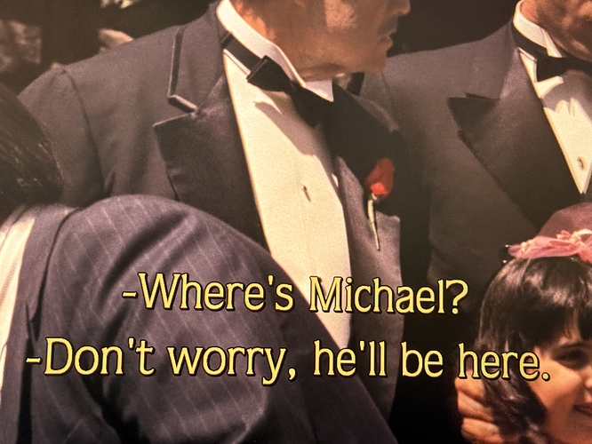

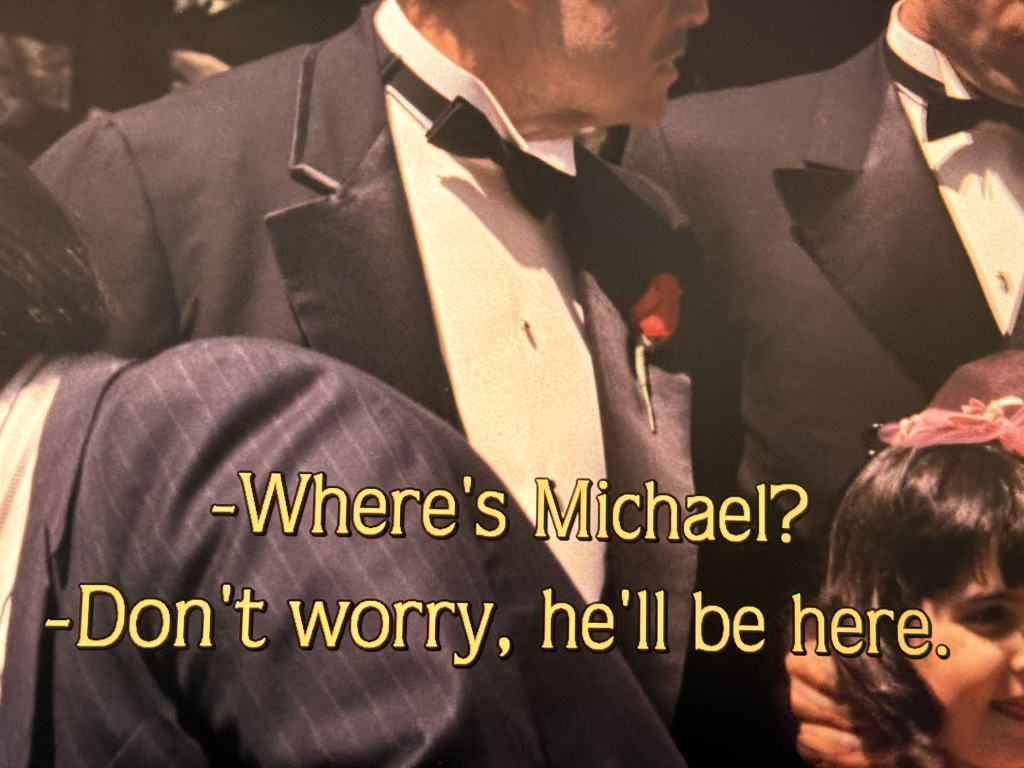

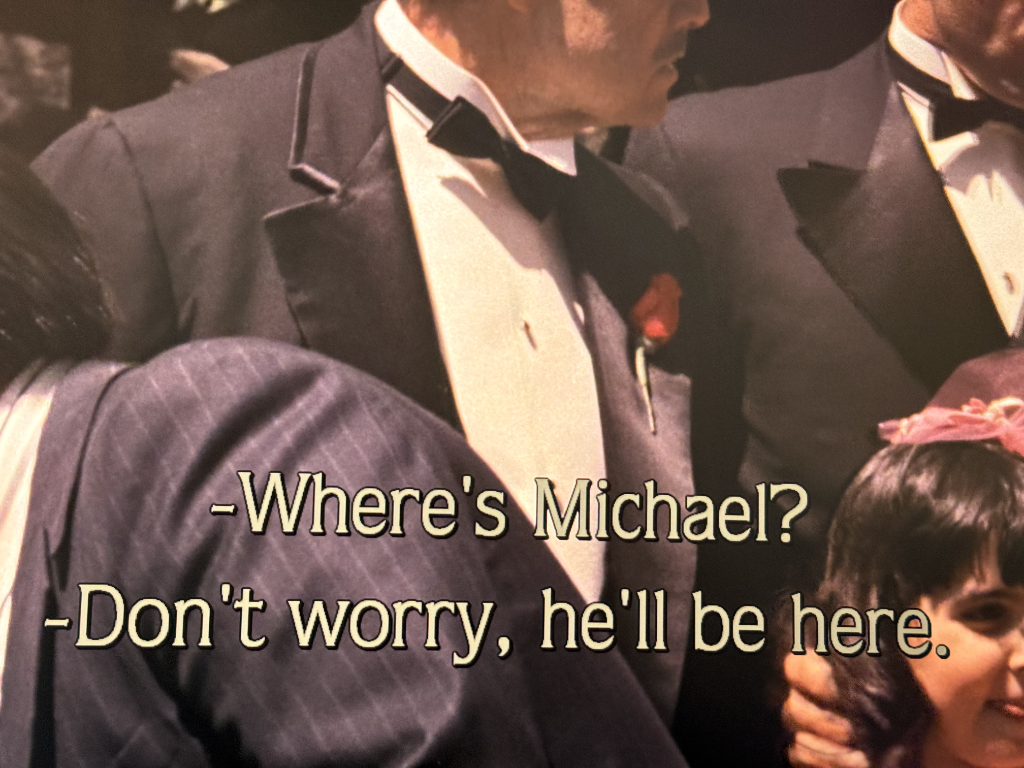

The issue as I understand it: UHD Blu-ray players can properly play UHD discs with PGS subtitles by applying some predetermined transform of the PGS subtitle image.
Most other players ignore this, making the subtitles appear with incorrect colors. This applies to all 4K Ultra HD discs/rips but is most noticeable on titles that actually use color in the subtitles, like The Godfather.
One player that gets this right is Kodi on Windows. Note that HDR has to be enabled in the Windows Display Settings for it to work.
Kodi on Windows (correct)
MPC-BE on Windows (incorrect)
Kodi on OSMC/Vero V (incorrect)
