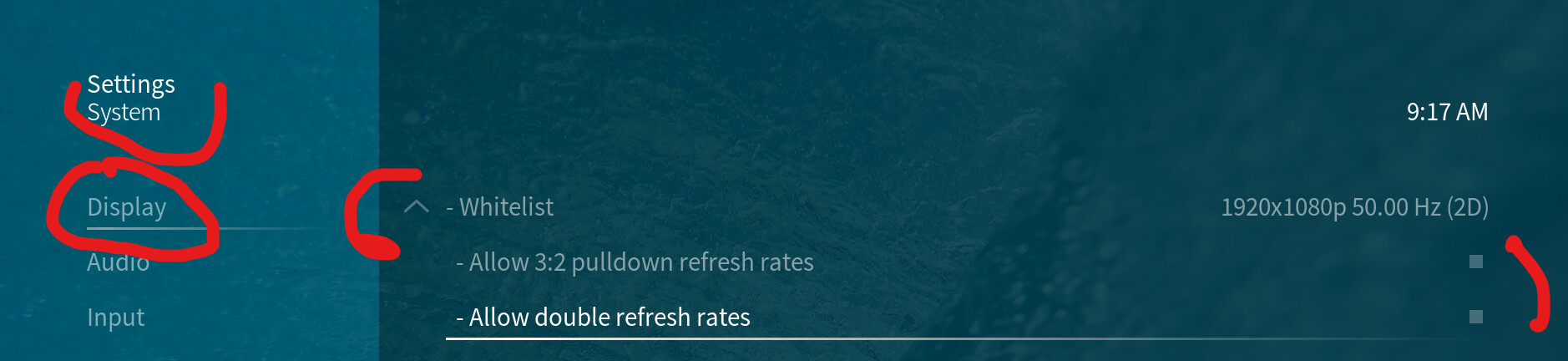

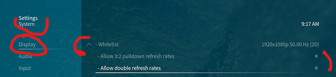

Hi, in the provided logs I see that you set a single whitelist display setting, namely
 <setting id="videoscreen.whitelist">0192001080050.00000pstd</setting>
 <setting id="videoscreen.whitelistpulldown">false</setting>
 <setting id="videoscreen.whitelistdoublerefreshrate">false</setting>
So, you have configured soemthing like
So, EVERYTHING should be played as 1920x1080p, 50Hz …
What happens, if you remove this whitelist setting? (New logs would be fine)

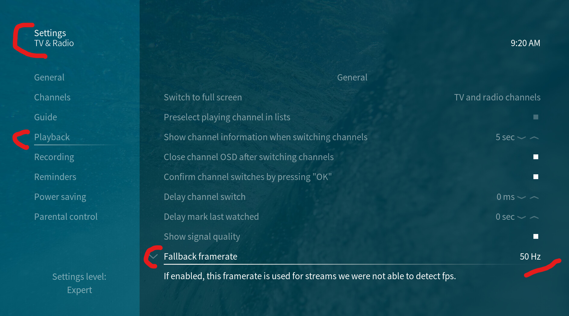

Also, you can try the following setting with your Tvheadend HTSP Client:
Hi @JimKnopf thanks for the response.
I removed 1920x1080p50hz whitelist (disabling 3:2 pulldown and double refresh rates) and also added 50hz as a fallback framerate.
Still experiencing issue unfortunately.
