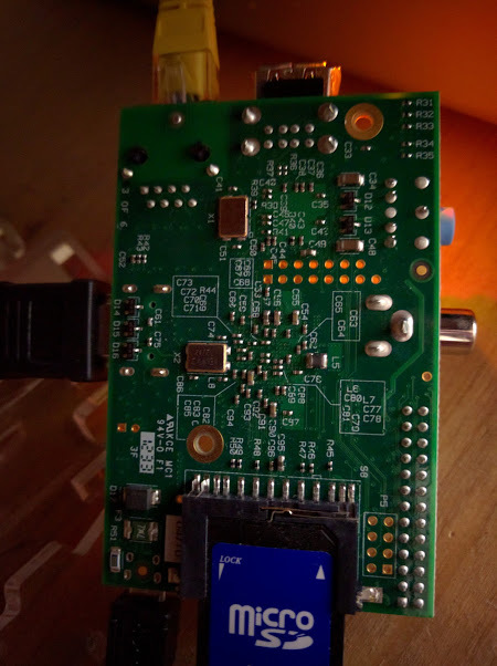

Are you sure you have a Pi 2 ? The Pi 2 does not say revision 2.0 on the board - from memory it is revision 1.1 or 1.2.
Sounds like you have a Pi 1 B+. Please provide a photo of the bottom side of the board or a close up of the writing on the top side of the board to confirm.
