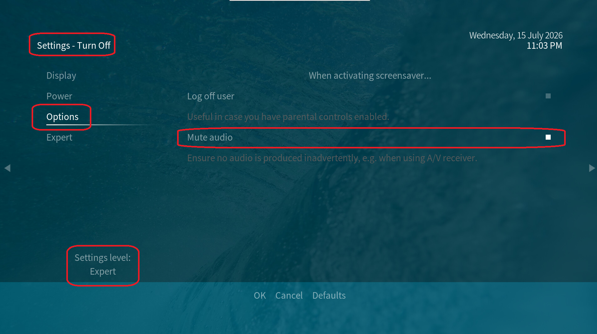

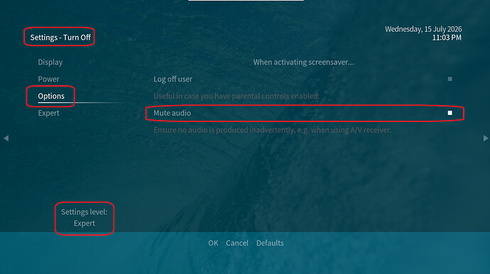

I’ve never used that ‘turnoff’ screensaver, but it looks to me like it uses CEC to tell the other devices to mute the sound. That is also its default setting:
I think that could explain the behavior you’re observing.
Try simply disabling that feature of the ‘turnoff’ screensaver, or use a different screensaver.
Oh man, nailed it. Yes, it was on the Mute audio default behavior. Thank you so much. I thought that that setting was what I had on the old box, but it probably was on black instead.
