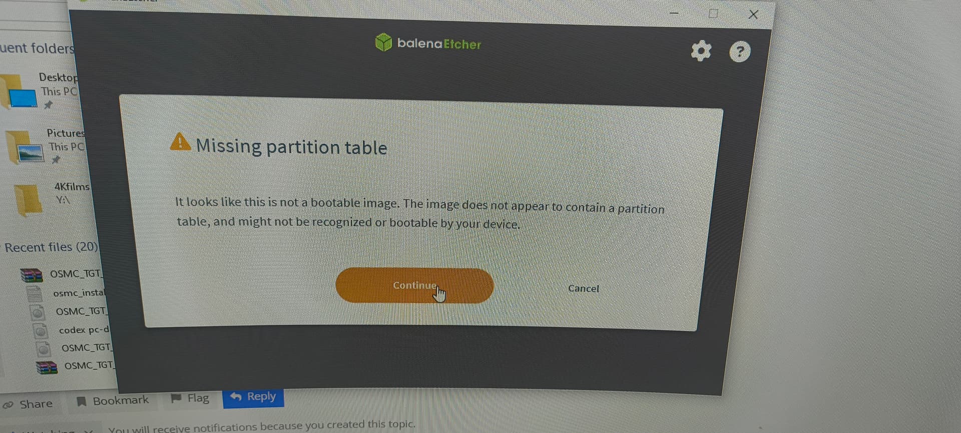

This is what I get on etcher, this is the zip file I downloaded from osmc,
I suspect you have not unzipped it.
Or I just checked - balenaEtcher works from the zipped file so no need to unzip it first.
