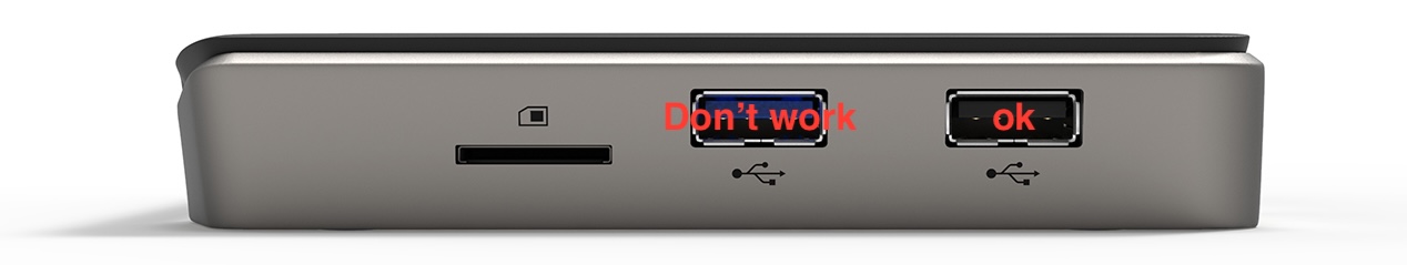

Do you have any other USB devices attached to the Vero?
Yes:
- Plugging a keyboard into the (black) USB2 hole works.
- Plugging a keyboard into the (blue) USB3 hole does not work.
I replaced two Vero 4Ks with two Vero 5s so I also have two old remotes and USB dongles lying around.
I tried every combination of USB dongle/hole/remote from the 4Ks on the 5, but none worked. If there is a way to un/re-pair those from the dongles I can give that go.

I also noticed that seams that only one usb port is working. I say that because as I plug the dongle in the working port I see logs in dmesg, in the other one dmesg remain silent.
I can confirm, the port marked “OK” works with a keyboard and the 4k dongle on my Vero 5, but the port marked “Don’t Work” does not.
Hi same issue,
USB2 port works, USB3 port does not work.
I did not notice before, but it is not related to match update, because I did clean installation and in the USB3 port USB flash drive with Vero V image did not work so I had to use USB2 port, where installation USB worked.
Also my third party remote controller with dongle works in the USB2 port and does not work in the USB3 port.
Just dropping by to the whole ‘remote not working after the March update’ thing. The remote was working before the update, because I used it to start the update. Currently got a keyboard plugged into the socket marked ‘ok’ on the above diagram. Many boots done, cold boots, unplugging, re plugging. Anyway, logs as requested https://paste.osmc.tv/ufaveranam
