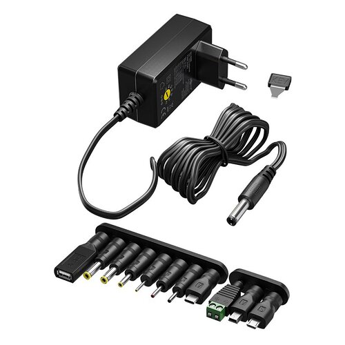

Might get something like this, might be good to test other stuff as well:
(sorry if showing in swedish, but pictures should be quite explanatory)
Since 5V, 2A is 10W, that adapter doesn’t look strong enough. Also note that the centre contact on the Vero’s socket is solid, so the PSU plug needs to have a spring connection (‘type M’) to make sure it connects properly.
