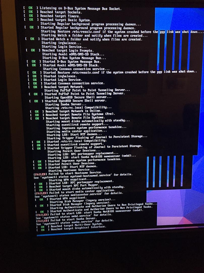

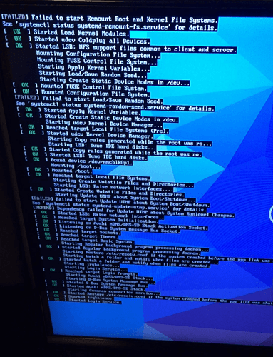

Now, when I try to reboot, I get a series of pretty serious sounding error messages on the screen:
Reading through the various systemd status messages it seems like everything is failing due to the filesystem being in read only mode.
When I try to edit any files on the device via SSH I get an error about the file system being mounted in read only mode.

Edit: Replaced second image with better quality.
