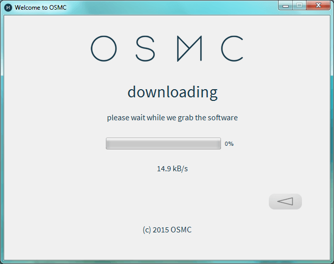

Can I ask why you’re not using the automatic download option in the OSMC installer though ?

Slow internet connection.
But i think i have to try installer automatic download option btw… :confused:
my internet speed is actually 128KB/s but i don’t know why installer downloads it this slow.

Even used the automatic download option but i got the same results as before.
