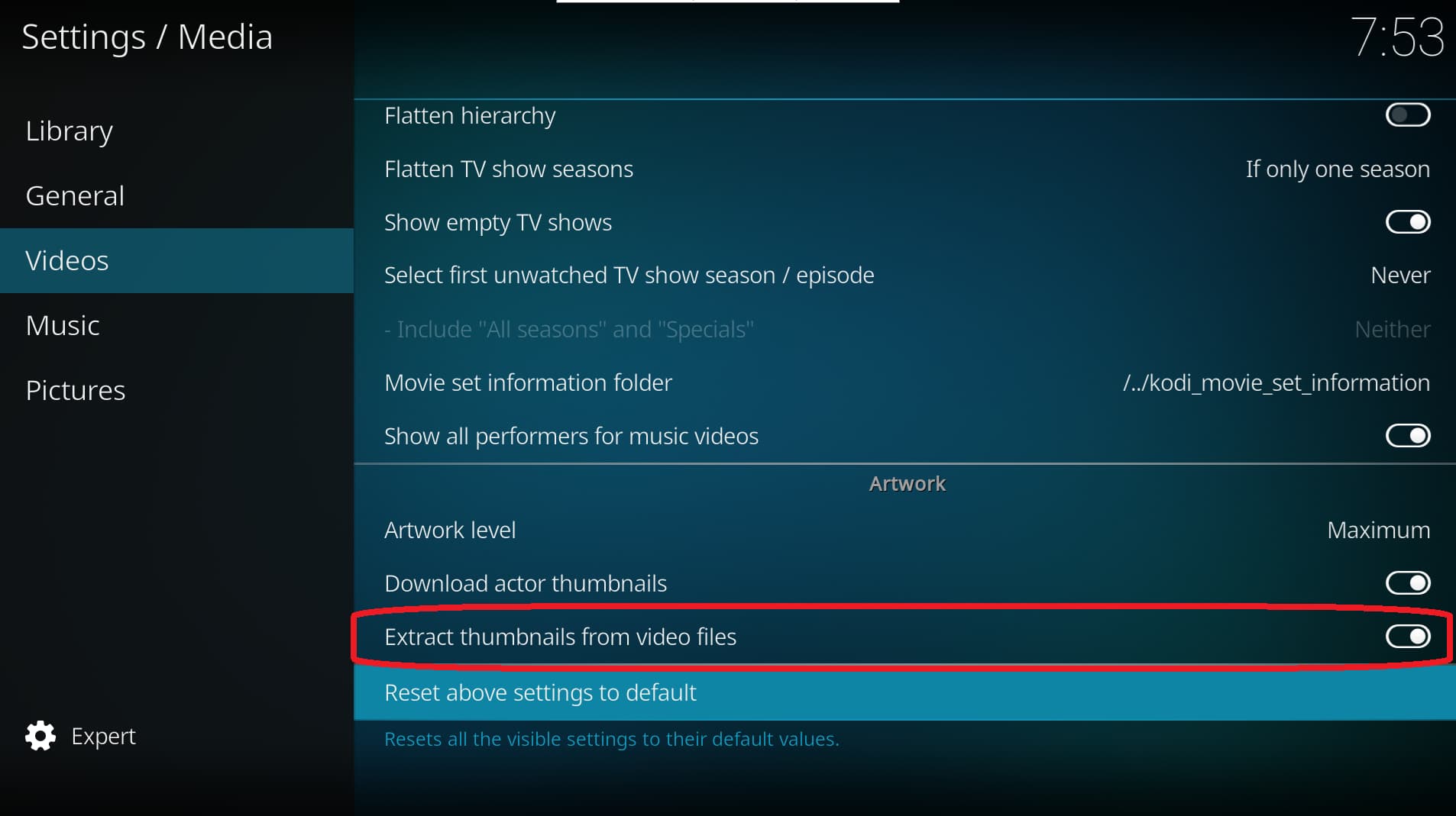

this is a bug that has been around for 6 months or so. There is a workaround posted here.
That must be a somewhat intermittent bug then, as I have a Vero V, am running Estuary, have that setting enabled, and haven’t had any problems with the memory on my Vero V. Right now it’s sitting at 403MB of memory used at idle.
The problem has been reported by many people now, common link seems to be new installs or full rebuild of artwork, for some reason only affecting Estuary. Of course if the workaround doesn’t work for the OP then it’s a different issue.
I have played with those settings, and they are never persistent. Whenever the device reboots, they default back to true. Right now, I am in the OSMC skin and rebooted. I have waited 1hr and the memory usage is 3.4GB. This is where it was when I first turned on debugging right after a reboot.
