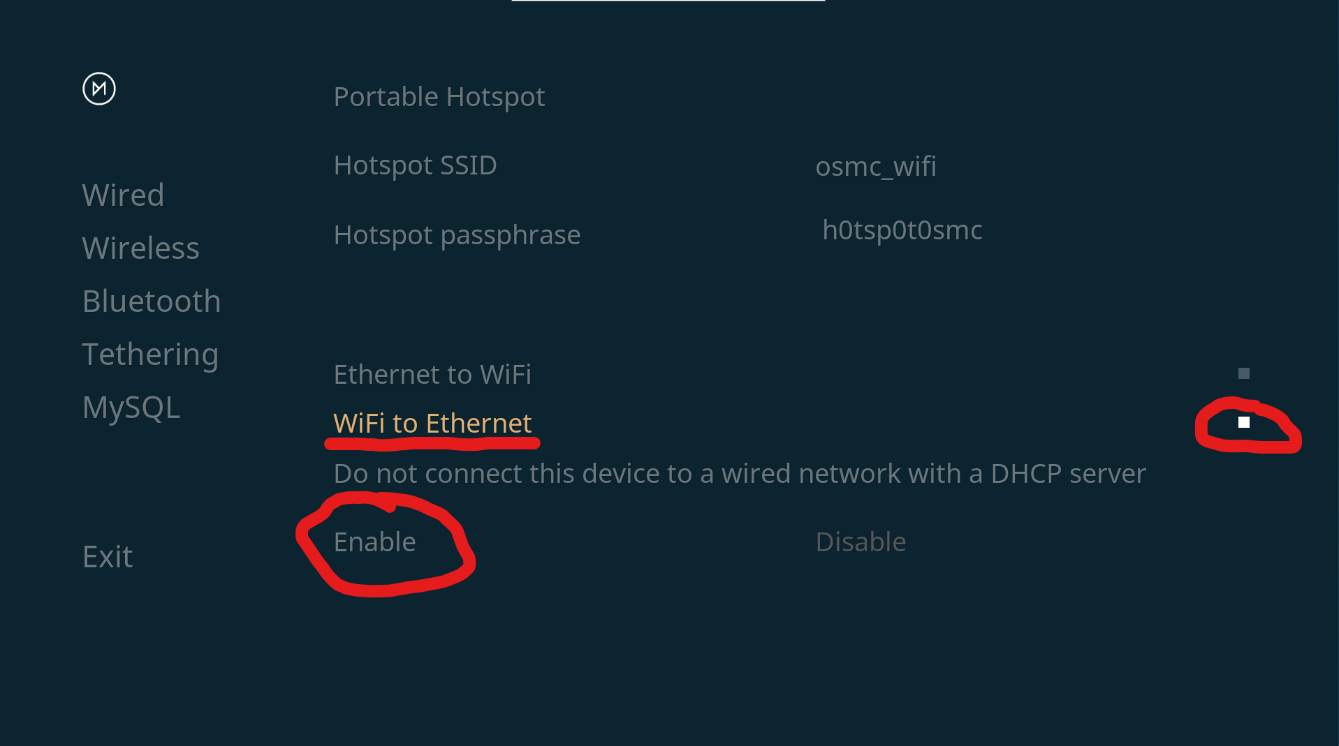

I suggest to try the Thethering method to get into contact with your Telestar device:
  • in MyOSMC ENABLE the wired adapter
  • the Wireless settings seems to be correct since you state you can even reach the internet when using wifi prefered
  • Now, in Thethering activate “Wifi to Ethernet” and enable this function
This makes the OSMC device a DHCP server on the ethernet port with the network range 192.168.0.0/24. Your Telestar device should get now ipv4 192.168.0.2 and the OSMC device will get 192.168.0.1 on the ethernet port.
From here the SAT>IP server should be visible (in theory).

Thanks Jim,
With “WiFi to Ethernet” tethering enabled:
  • OSMC can reach the internet
  • Telestar device is not found (no adapters showing in tvheadend)
  • but I can ping 192.168.0.2 from OSMC
This is the same for either setting of PreferredTechnologies.
Log is here: https://paste.osmc.tv/okibigapol
