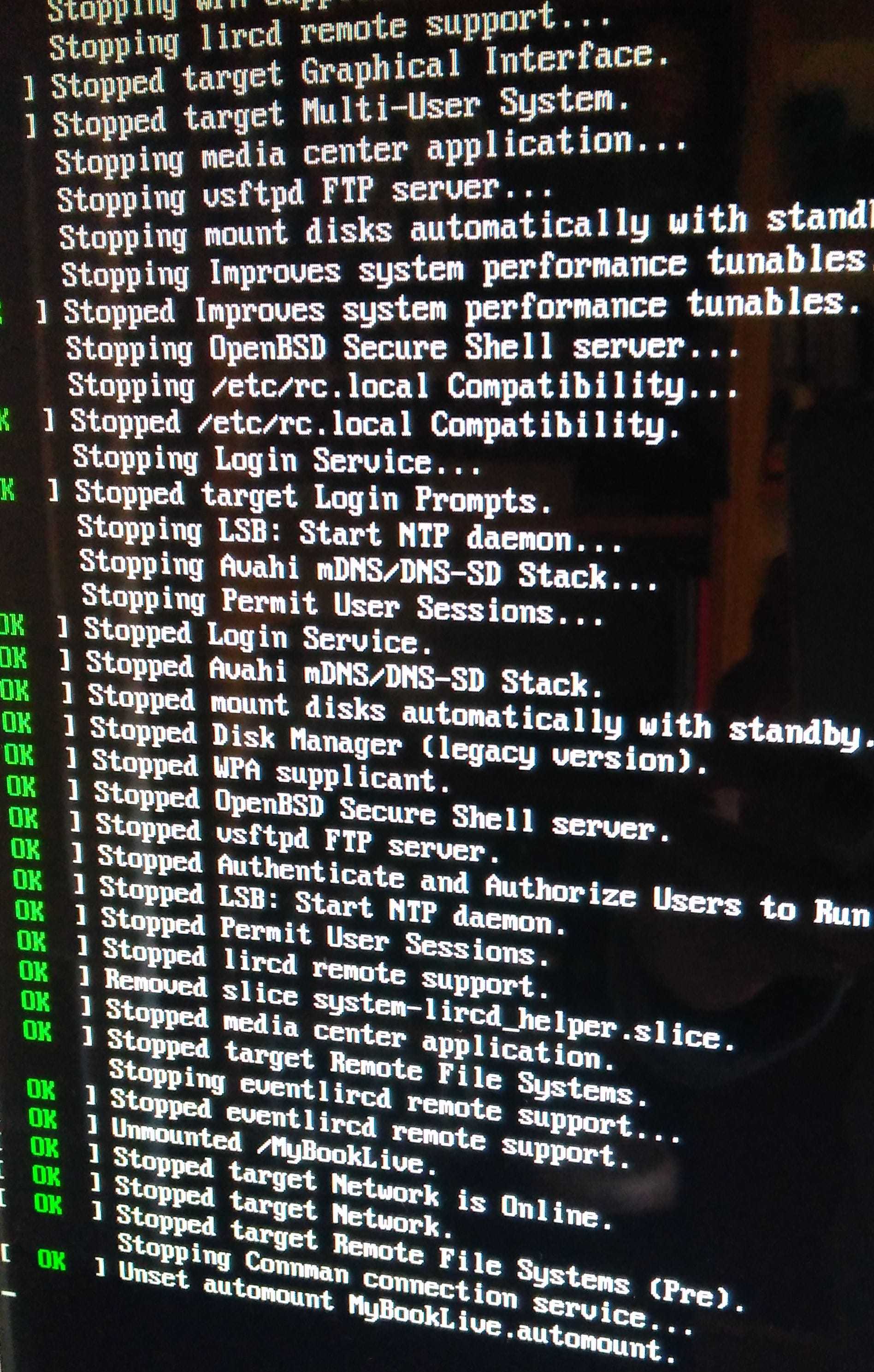

Edit /boot/cmdline.txt and change the word quiet to noquiet.
Boot up then shutdown. When it gets to the bit where it is waiting for NFS take a photo of the messages on the screen and post it here.

Here is the photo of the screen during the shutdown with the noquiet mode enabled.
Definitely, the Wi-Fi is one of the first things disconnected when the Pi is shutting down. Maybe changing the disconnection priority of the peripherals will do the trick, but I don’t know how to do it.
What I don’t see in your screenshot is “Stopped Connman connection service”.
Connman is responsible for bringing up and taking down the network. Do you see a line like this before or after what you have posted a photo of ?
Also can you temporarily try connecting over Ethernet (unplug your wifi adaptor as well) and see if you see this issue ? It’s possible that it’s a wifi only problem.
I have tried with Ethernet and the problem is the same.
And about the “Connman connection service”, that service is shutting down just after the wait of 1:30 minutes, as you can see in the next photo. So maybe the problem is with another service that kills my connection before the Connman, no?
