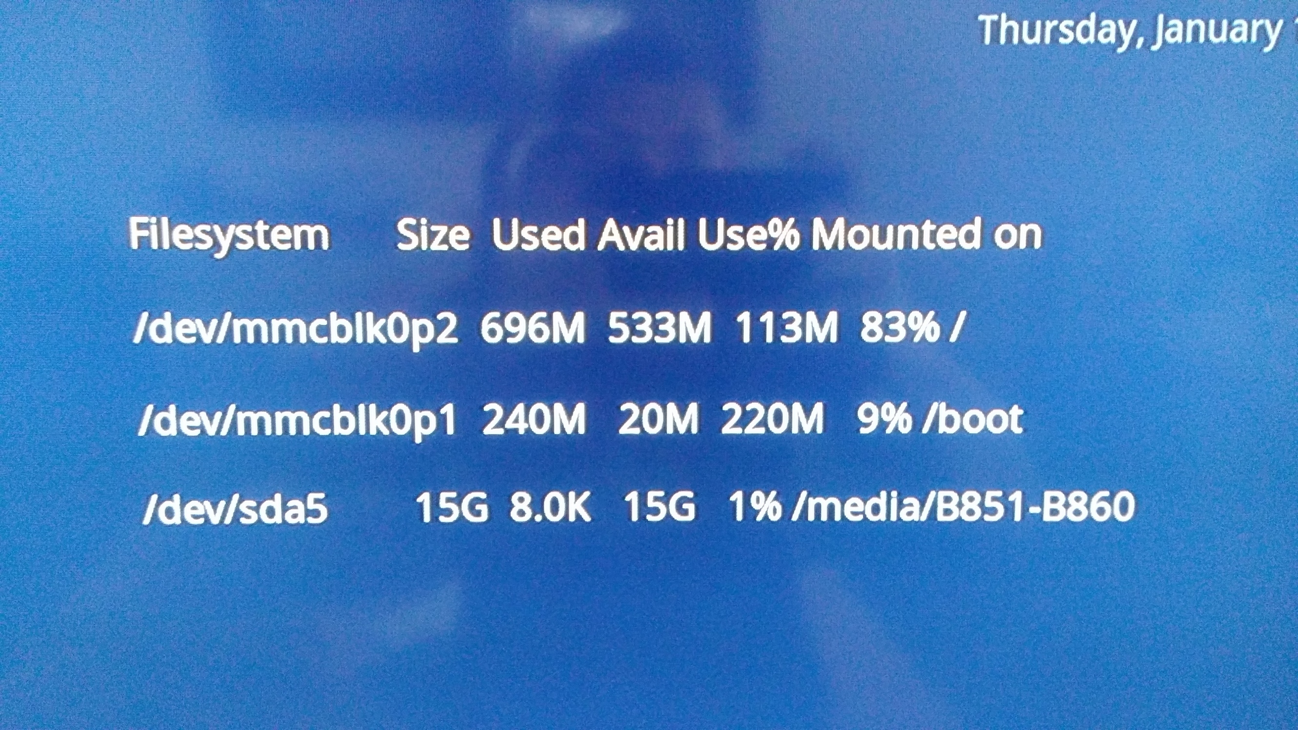

I’ve tried it multiple times, but it keeps installing it on my SD card. How am I sure of this?
  1. It crashes if I pull out the SD card, even long after it’s done booting, which it shouldn’t as far as I understand.
  2. The USB stick has 8 KB of data on it and the SD card has 113MB on one partition and 220MB on another.
In the installer, I chose “on a USB stick”, and the chose the SD card when prompted to choose the device.

I didn’t touch it until OSMC was up. Maybe I mistyped the numbers, but the SD card is 1GB so it couldn’t be much more. I think the problem is with partitioning as I stated in my reply, and the system recognized the 2nd SD partition as an external device. I’m retrying it now and will update soon.

The numbers were wrong, I was quoting the available memory.
The memory used is 20MB on the 1st partition, and 533MB on the 2nd one.
