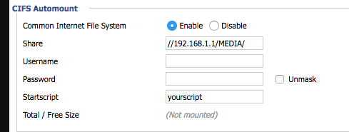

Terminal didn’t respond since I typed your command. Okay, try again. I am using two partitions of my hard drive in NTFS, ntfs-3g in my router for NTFS support. I turned on Samba file sharing in NAS tab. I am configured for this partitions username and password plus allow it for guests. Now I can connect to NAS from my computer, my phone and OSMC. Now I want download torrents to my NAS via Transmission. Via SSH from OSMS:

I find in settings CIFS, maybe I must configure this?
