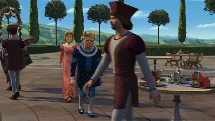

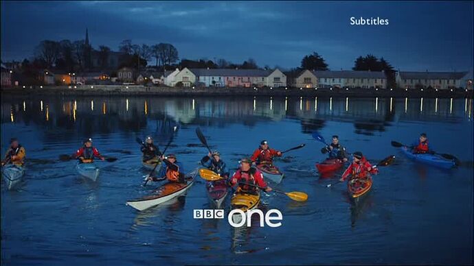

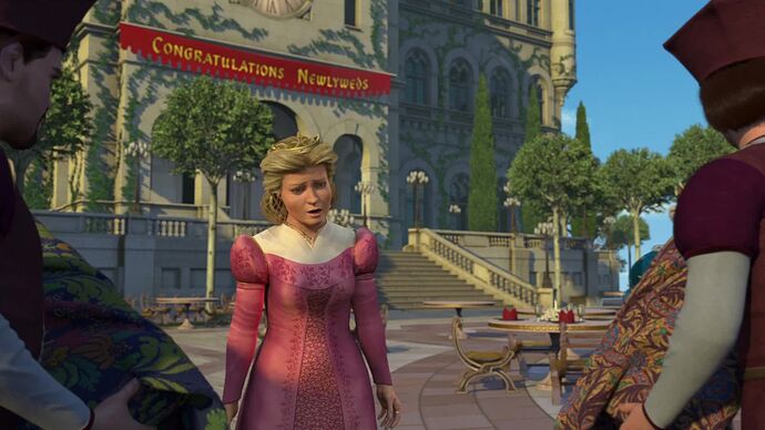

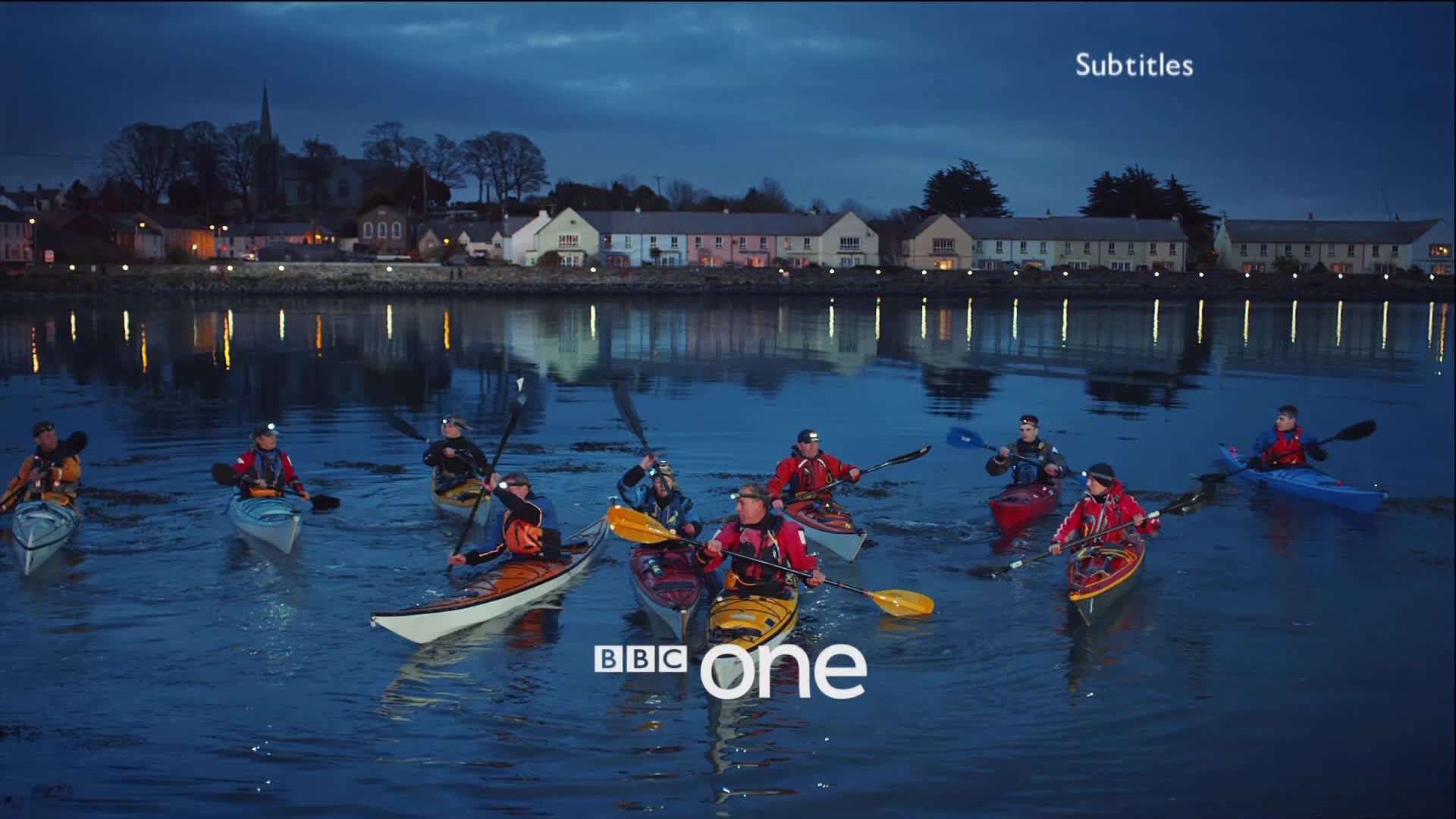

OK, so I’ve put in a network switch at the TV so I can run the Rpi3 and Vero4k at the same time and just A/B by switching source.
Examining BBC1 I’ve made simultaneous recordings from the SD and HD streams.
I did this for “EastEnders” and later for “Shrek 2”.
The quoted mediainfo output is for the original .ts files, rather than the short .mkv cuts I’ve uploaded.
Video
Menu ID : 17540 (0x4484)
Format : AVC
Format/Info : Advanced Video Codec
Format profile : High@L4.0
Format settings, CABAC : Yes
Format settings, ReFrames : 4 frames
Format settings, GOP : M=8, N=24
Codec ID : 27
Duration : 29mn 1s
Width : 1 920 pixels
Height : 1 080 pixels
Display aspect ratio : 16:9
Frame rate : 25.000 fps
Standard : Component
Color space : YUV
Chroma subsampling : 4:2:0
Bit depth : 8 bits
Scan type : MBAFF
Color primaries : BT.709
Transfer characteristics : BT.709
Matrix coefficients : BT.709
Video
Menu ID : 4163 (0x1043)
Format : MPEG Video
Format version : Version 2
Format profile : Main@Main
Format settings, BVOP : Yes
Format settings, Matrix : Custom
Format settings, GOP : Variable
Codec ID : 2
Duration : 29mn 10s
Bit rate mode : Variable
Bit rate : 2 510 Kbps
Maximum bit rate : 15.0 Mbps
Width : 704 pixels
Height : 576 pixels
Active Format Description : Letterbox 16:9 image
Standard : PAL
Color space : YUV
Bit depth : 8 bits
Scan type : Interlaced
Scan order : Top Field First
Compression mode : Lossy
Bits/(Pixel*Frame) : 0.248
Stream size : 524 MiB (84%)
Video
Format : AVC
Codec ID : 27
Duration : 1mn 10s
Color space : YUV
Bit depth : 8 bits
Scan type : Progressive
Video
Format : MPEG Video
Codec ID : 2
Duration : 4mn 37s
Bit rate : 2 582 Kbps
Width : 704 pixels
Height : 576 pixels
Standard : PAL
Color space : YUV
Bit depth : 8 bits
Bits/(Pixel*Frame) : 0.255
Stream size : 85.3 MiB (84%)
In each case the live stream played fine on the Rpi. On the Vero the SD was fine but HD juddered.
The same result when playing back the recordings from each device - only HD juddered on the Vero.
In all cases the tv switches to 50Hz (set to auto switch).
Mediainfo on all files indicates 25.000 fps.
The fps reported from the info button at playback:
				Rpi3	Vero
Eastenders SD	25		50
Eastenders HD	25		50
Shrek2 SD		25		25
Shrek2 HD		25		50
So the reported fps on Vero4k is different not only between SD/HD but also between programmes from the same channel.
I hope this gives you something to work with. Please do let me know if there’s anything else I can provide.
