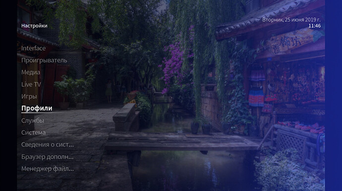

After I changing system language from English to Russian I have this mess in “System information”
I remember, that I fixed that on my other device something about 1-1,5 years ago, but I can’t remember how. Can someone help me pls?
Change your font (Settings > Interface > Font) from Default to Arial should fix that.
Thnx for fast answer.
This helped a little )
We changed some things about our skin font and I only noticed these issues with Cyrillic glyphs now… Will have a look into how this can be fixed.

Hopefully the issue is now addressed with the following commit: Update font files · osmc/skin.osmc@1eef9c5
I’d appreciate it if you could test this and provide feedback before we potentially release this as an update to other users. It will take about an hour to be available in our staging repo. To test this update:
/etc/apt/sources.list
deb http://apt.osmc.tv stretch-devel main
sudo apt-get update && sudo apt-get dist-upgrade && reboot
I also recommend you edit /etc/apt/sources.list again and remove the line that you added after updating. This will return you to the normal update channel.
Yeah, now it looks fine.
Unfortunately, yes. Those items either don’t have a translation by Kodi or by us. We add localizes to the skin that Kodi doesn’t have, but currently we only offer English versions of the localizes for a lack of a good translation solution.
I’ll fix the Interface subsection of settings though for the next update. There’s a translated localizes by Kodi that I can use…
