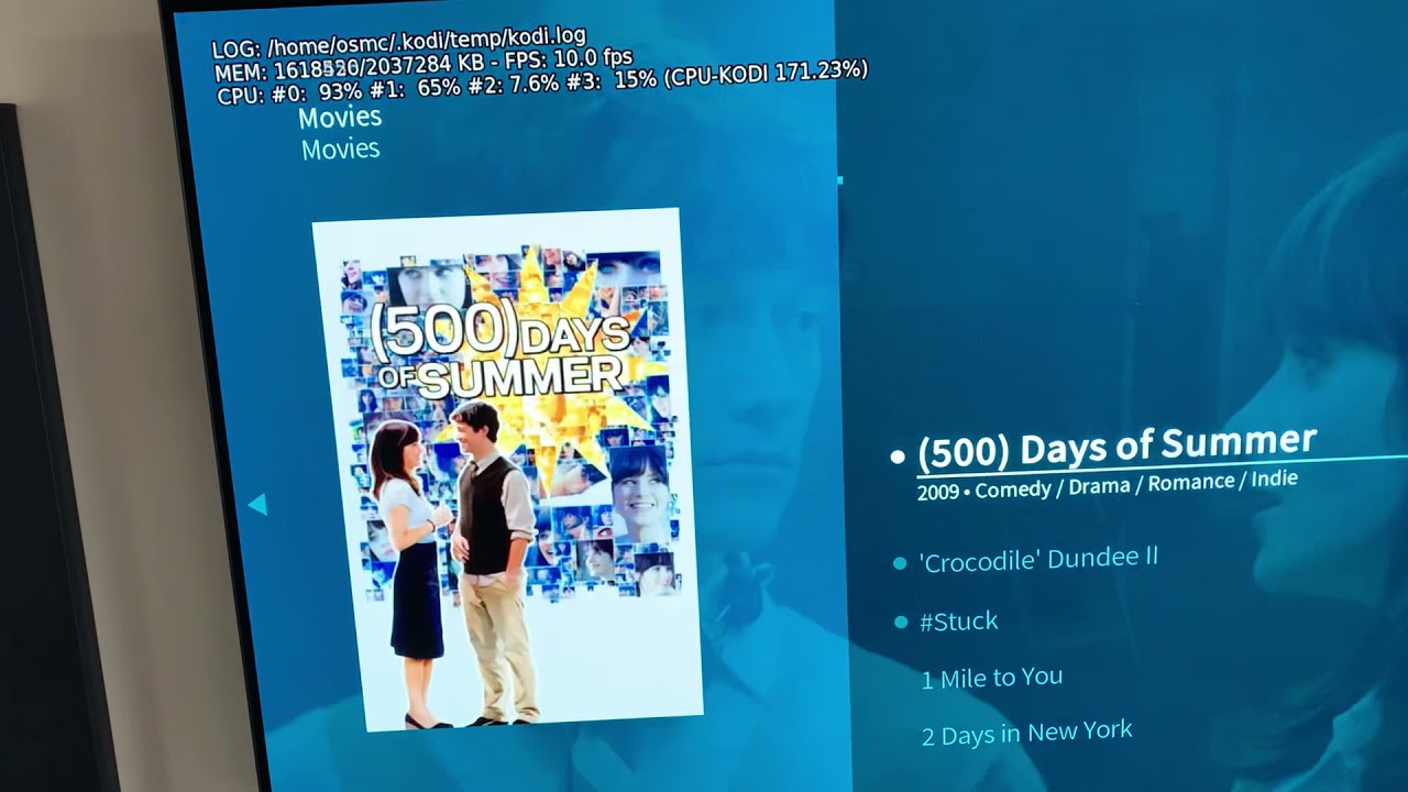

Has anybody seen any issues with memory leaks causing a crash when just navigating around the movie section. The memory suddenly races down to around 500MB of memory and then you get sad smiley.
There doesn’t appear to be anything in the logs as the process gets killed before it can presumably flush the logs.
What’s the best way of tracking it down, happy to post the logs but they don’t show much.
Have a video of it and it appears to happen on both Vero 4K+ boxes that I have. Presumably, because one is a clone of the other. On the default OSMC just a few down button clicks on the remote will cause it. Page down, however does not seem to cause it to do so.
I am using mySQL as a shared database but haven’t seen this on the previous Leia build.
The last time it happened I was actually back to the main menu when it crashed.
What is the size of your library (number of movies) ?

It’s around 2,000 from memory so quite large but was working before upgrading
Have a video of it here, that hopefully shared ok. It only starts eating memory if I click on the down button to start navigating.

Ok, must be a problem in yesterdays build as it was working the day before. Might just be a compile issue that could be fixed in the next days.
