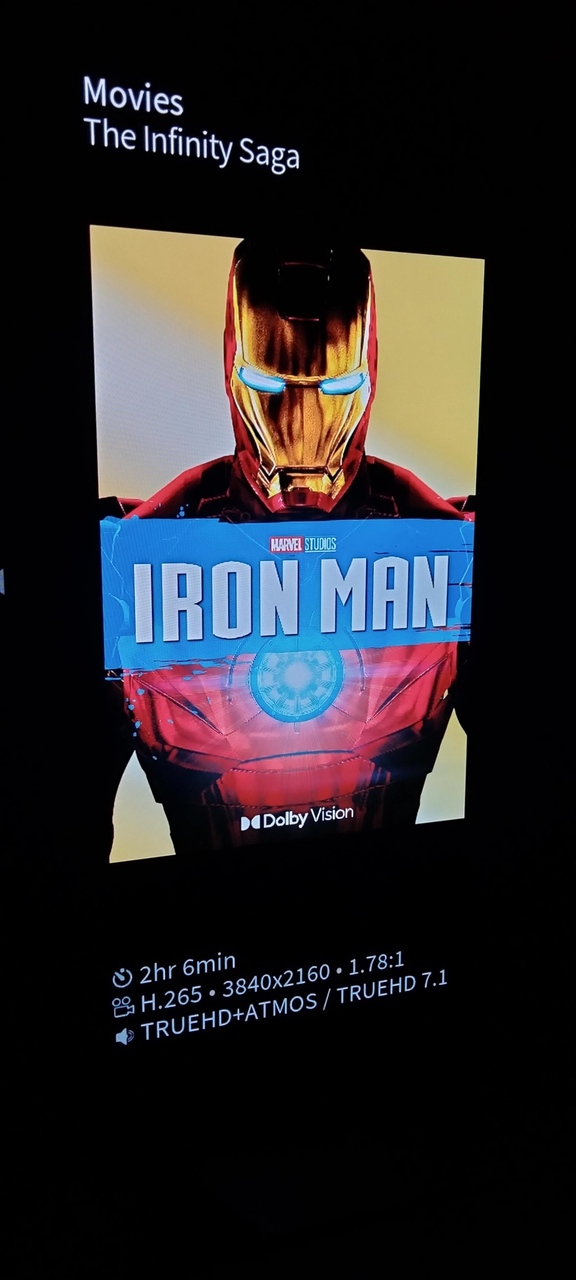

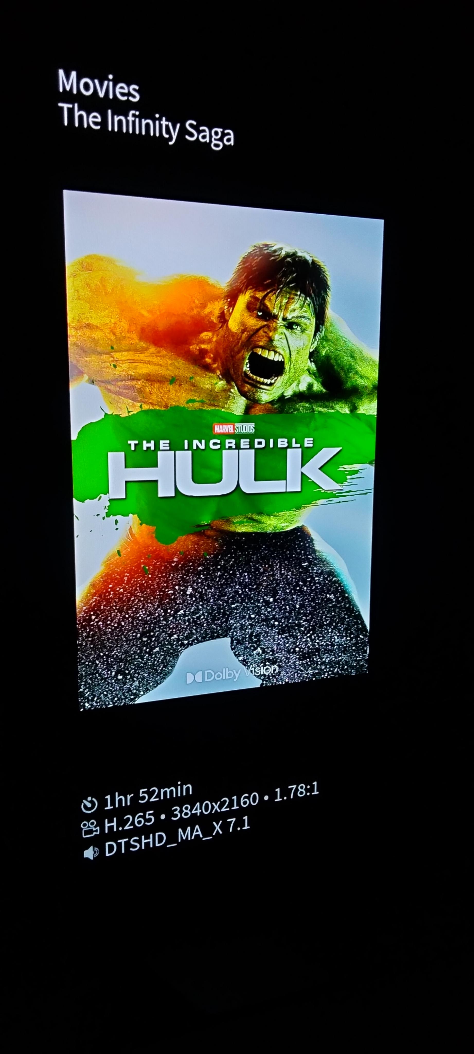

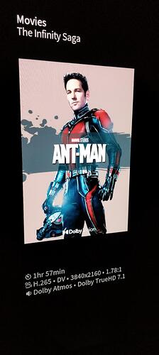

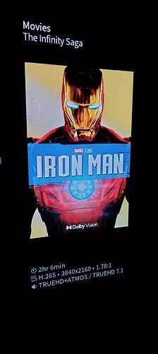

How I expect titles to look:
What I am getting now:
Both are missing the HDR type (they are DV) and the audio description looks weird.
Hulk used to say DTS:X * DTS-HD MA 7.1 and Iron Man used to look like Ant-Man does.

EDIT: I figured it out. For some reason Ember decided to start writing this garbage to NFO files. I never told it to do that so I’ll have to do some research regarding that but if I remove that from the NFO and re-scrape then everything looks as it should be again.
Example from Hulk:
<fileinfo>
<streamdetails>
<audio>
<bitrate>6787</bitrate>
<channels>8</channels>
<codec>dtshd_ma_x</codec>
<language>eng</language>
<longlanguage>English</longlanguage>
</audio>
<subtitle>
<forced>false</forced>
<type>Embedded</type>
</subtitle>
<video>
<aspect>1.778</aspect>
<bitrate>5750</bitrate>
<codec>hevc</codec>
<durationinseconds>6732</durationinseconds>
<height>2160</height>
<width>3840</width>
<filesize>54135736148</filesize>
</video>
</streamdetails>
</fileinfo>
Sorry for the false alarm guys.
