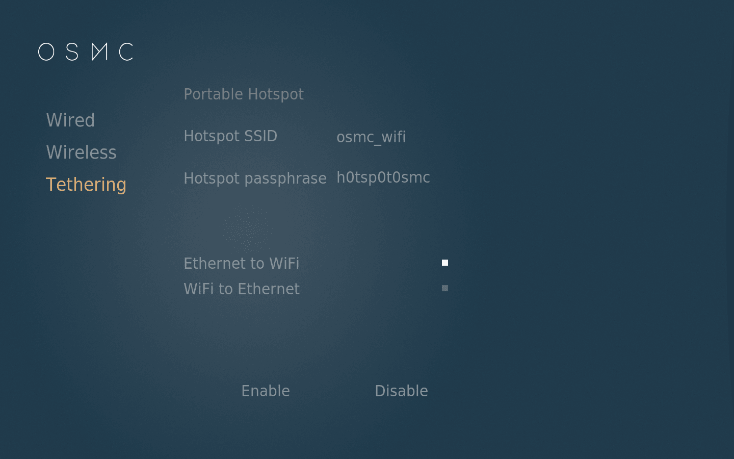

Is your OSMC install up to date ? If you have both an Ethernet and Wifi connection you will get a Tethering option appearing in networking below Wireless.
If you don’t you are probably running an old version of OSMC, so use the updater to bring it up to date.
hi guys, thanks…
i rebuilt it on the latest image and its working fine ;c)
