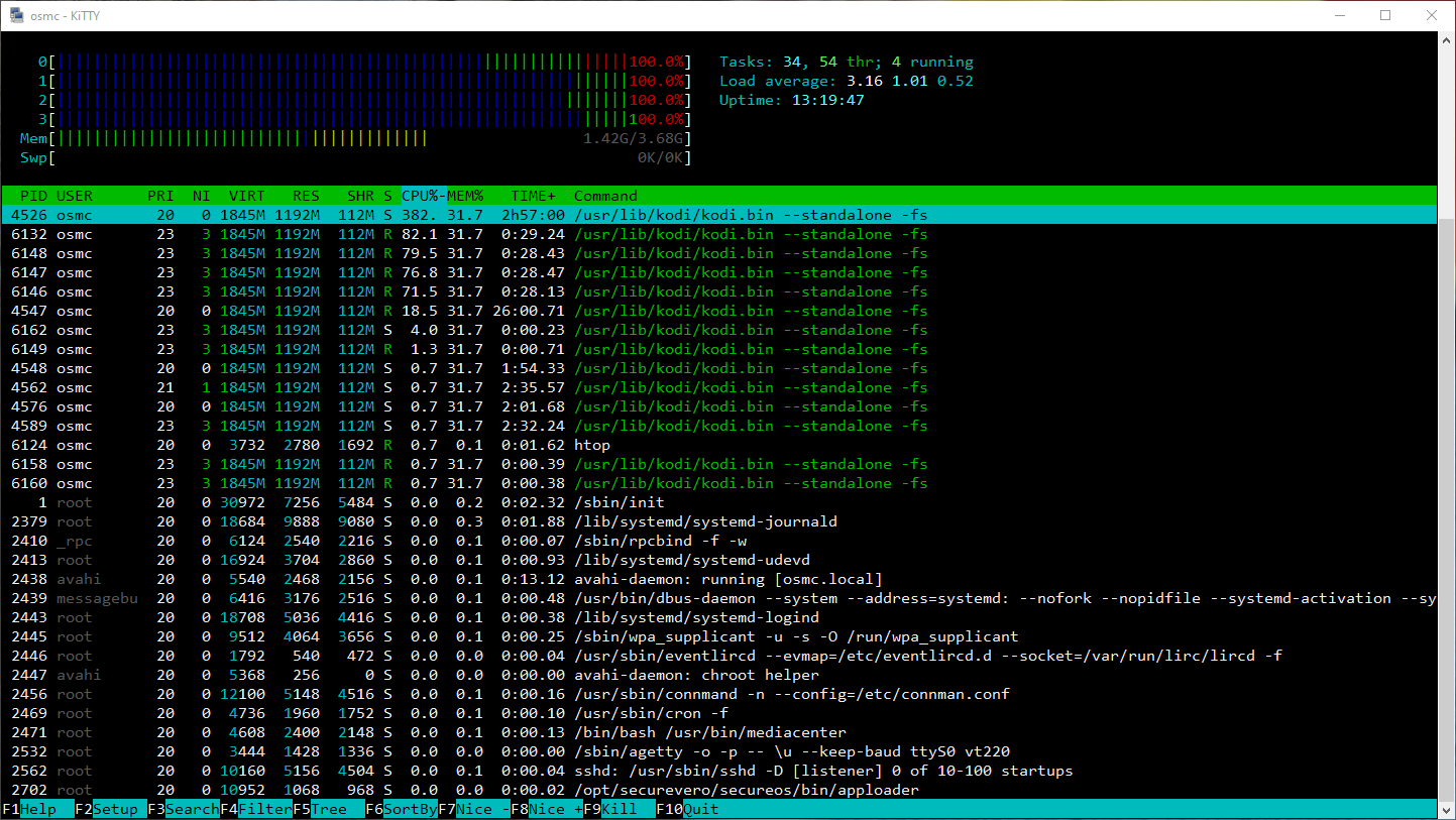

I’ve installed Wireshark on the Vero V to check the network traffic as the main menu is slowly rendering. The capture shows that there is NO network traffic to or from the Vero at this point, neither to the Internet nor to the NAS. So, it seems the slow rendering is caused by something entirely internal to the Vero.
When all this is going on, the CPU load on all cores goes to 100%:
As this is a new install, I’m willing and able to run any tests that might be helpful in identifying the cause, provide logs, run test builds, etcetera. If there’s anything I can do, please let me know.

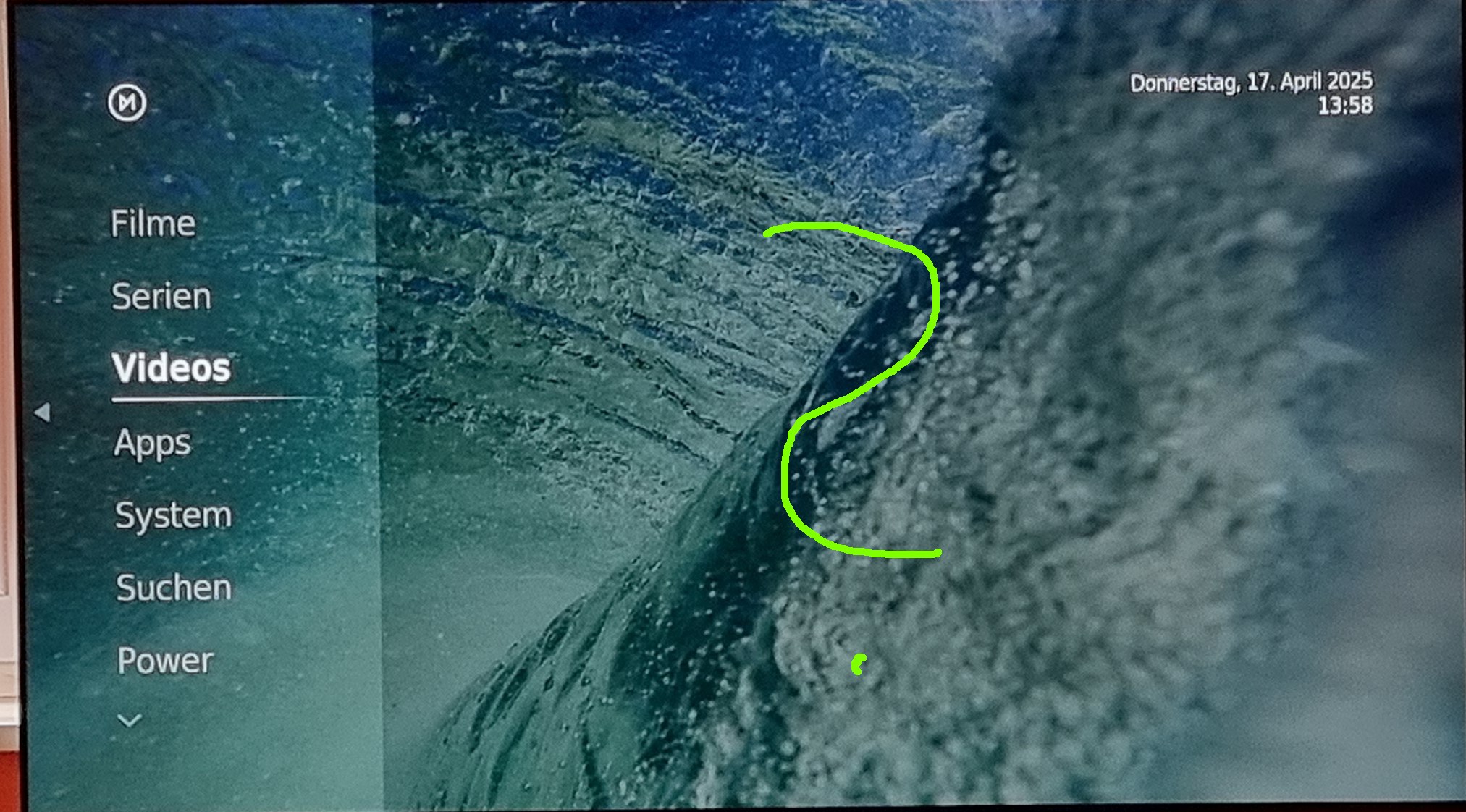

Can anyone tell me how to get movies and TV shows on the home screen with the OSMC skin? See photo.
You need to have the cursor focus on ā€œMoviesā€ or ā€œTV Showsā€ in order to show the covers. They aren’t shown when focusing ā€œVideosā€, but first of all I would suggest resetting the main menu to default. Go to ā€œSettingsā€, ā€œInterfaceā€, ā€œSkinā€, ā€œConfigure skinā€, ā€œGeneralā€, ā€œCustomize main menuā€, ā€œRestore menu itemsā€ at the bottom, ā€œReset to skin defaultā€. When it the asks to ā€œImport menu from skinā€, click cancel. Then go back to the main menu. By default, the ā€œMoviesā€ and ā€œTV Showsā€ section should show random entries.

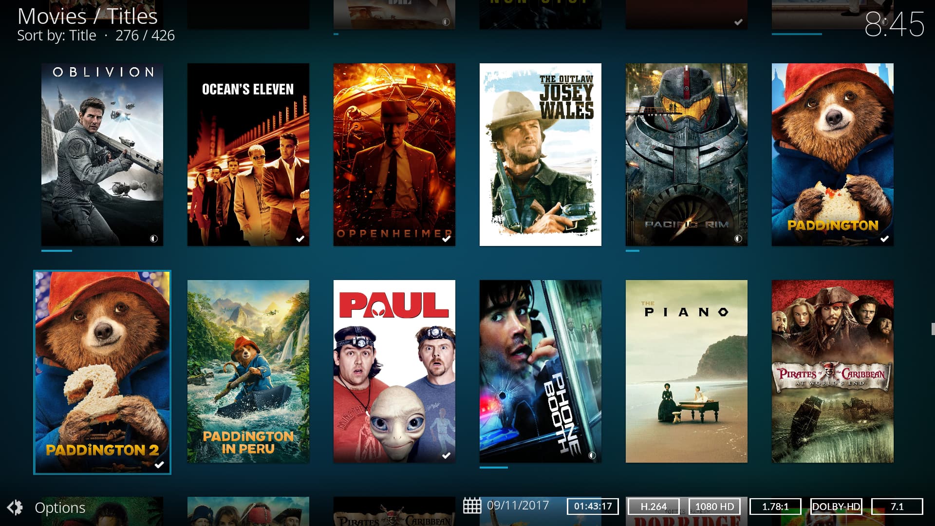

My main issue with the OSMC skin is how much of my screen isn’t being used when I’m browsing movies with the thumbnail view. Estuary shows the same number of thumbnails but at larger scale as it’s using all the screen, via the OSMC skin the thumbnails are much smaller as the whole screen isn’t being used.
Don’t know what you mean by thumbnail view but by my count, sort of equivalent views in OSMC and Estuary show 7 and 5 and a bit covers respectively.
Ah, if you mean Wall view you get more info in OSMC, but horses for courses.

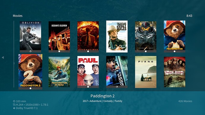

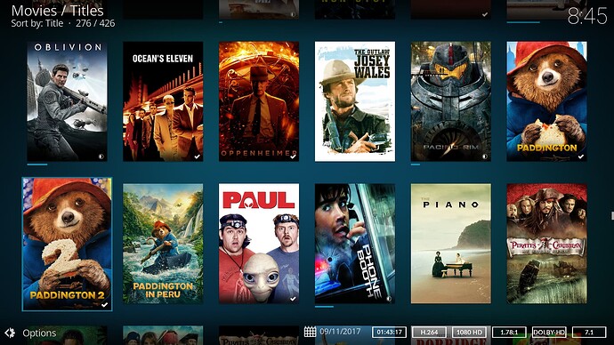

Appreciate I’m dragging the thread off topic of fixing Estuary movie thumbnails, but here is what I mean regarding OSMC vs Estuary skins in wall view. With the OSMC skin, there is a large amount of screen real estate not being used, resulting in thumbnails that are smaller than they could otherwise be, yet the number of thumbnails shown is the same as Estuary. Appreciate preferences on this will be subjective.
