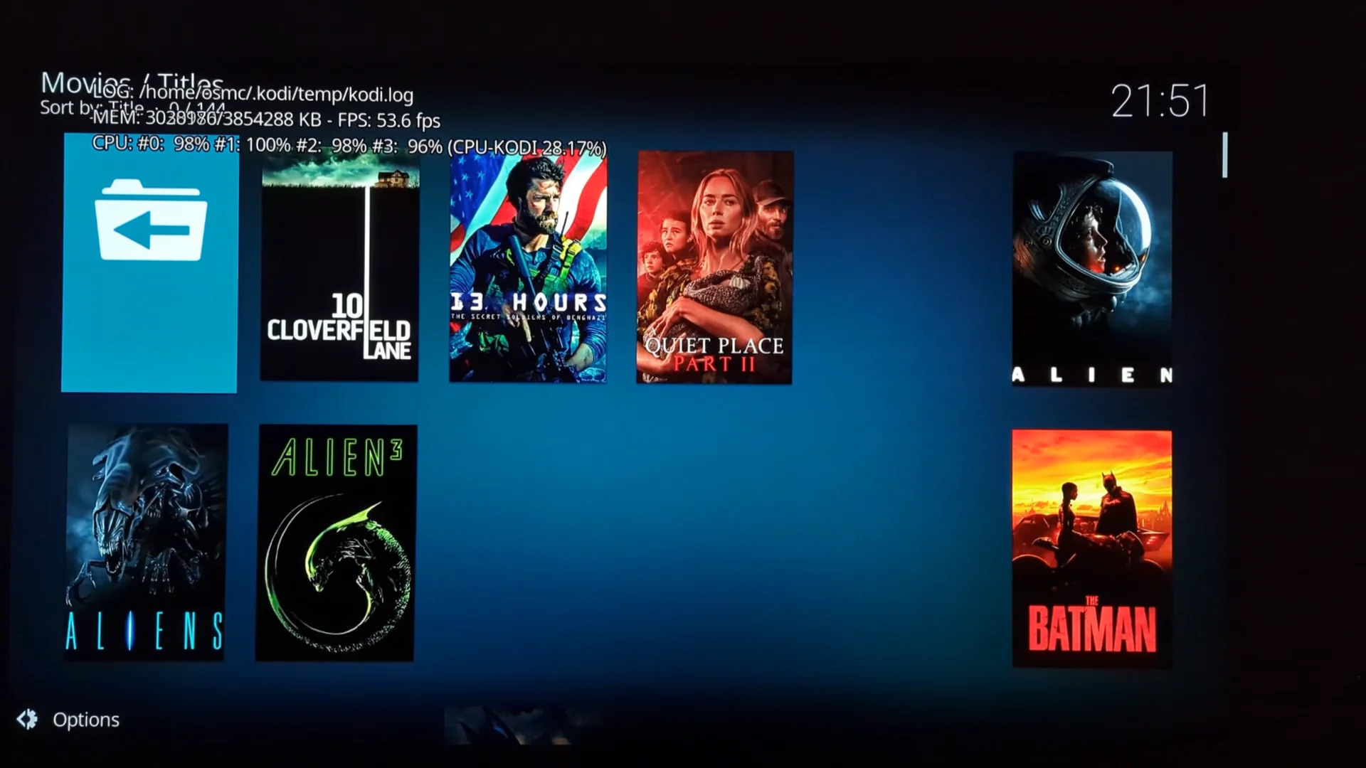

When scraping movies, I noticed that there is an issue regarding the thumbnails.
Logs
One thing to note: it seems to only affect thumbnails of certain views. When I use the List view, everything seems to work, but all Wall views and some others are showing this issue.
Also, as you can see, the CPU load is very high.
There is an additional issue which you can see in the video. After stopping playback, some menu items are stuck in this loading animation for a couple of seconds. This issue was the reason why I decided to do a reinstall as it behaved that way for the last couple of weeks. But clearly the issue still persists, even after the reinstall.
Maybe these 2 issues are related.
Hmm this is weird. After I shutdown the Vero and also shutdown the Windows PC which has the HDD with the SMB shared attached, all the thumbnails were suddenly there when I restarted the Vero. Maybe the is something wrong with my network.
Still, sometimes when I navigate into the movies library, many thumbnails don’t show. If I then go back to the home screen and enter the library again, they suddenly appear.
After connecting the share again, the issue reappeared. I’d be very grateful if someone might be able to see in the logs what the problem might be.

I now doubt that there is a network problem, because plugging the HDD directly into the Vero didn’t help either. I quickly installed Kodi on my Windows machine and I didn’t have any issues there, so I’m not sure what else to try.
I did a lot of scrolling. The images appear after time, but first it takes ages and when I then return to the home menu and enter the library again, most of images are gone again and the waiting begins again. It feels like it struggles to actually cache the images. Is there some limit on how big a single movies folder can be until it starts struggling? Not talking about the amount of movies but rather the total file size of all items in a single folder.
Btw I tried this even with the 2024.08 version, but same result. So I don’t think this was introduced with a recent update.
Is it possible that I’m hitting a caching limit somehow?

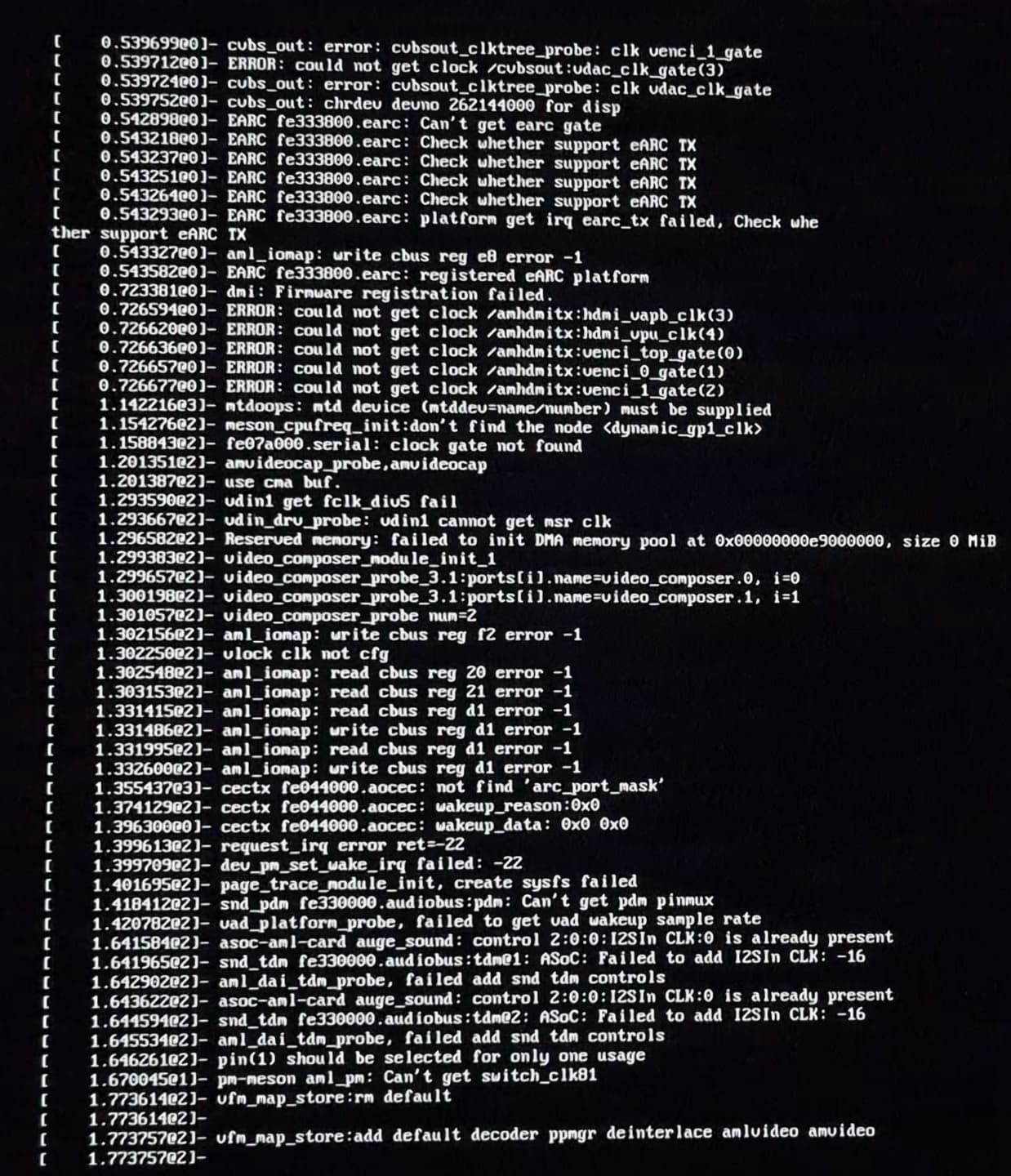

These messages are fine (just a bit of noise) as the kernel probes on boot. I could hide it but don’t like doing so as it makes it easier to identify actual problems should they arise

Kodi under normal conditions will try to load a set number of images around where your selection is. The process of caching the images is relatively slow and I believe if you scroll on before it finishes with its active cue you might lose some progress at that very moment as it moves on to getting the artwork for the items around where you moved to. If you monitored it using top via ssh while you navigated into your library I’d suspect you could get an idea on how long it was taking to finish any given section you navigated.
