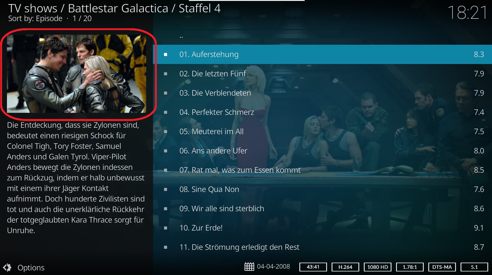

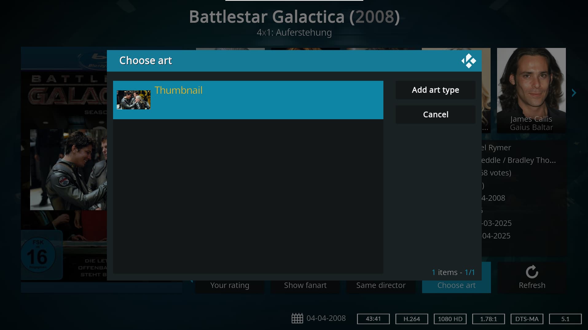

Even the TV episodes thumbnails?
Yes, these thumbnails are not affected by disabling Extract thumbnails from video files
. Tested this by setting the content of movies and tv shows to none
including removing all content from the libary, stopped the mediacenter, removed the thumbnails folder and Texture.db, restarted the mediacenter and finally ⌠set the appropriate content with a following scraping run. All ok, here.

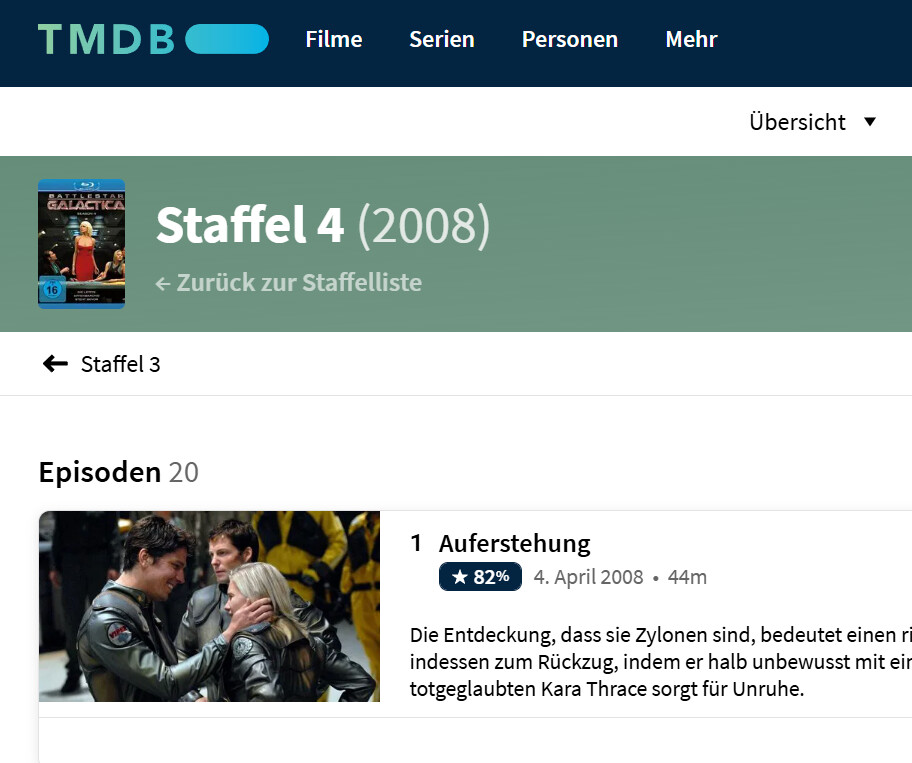

Alright, I need to test if this is also true when using the TVDB as the selected scraper.
