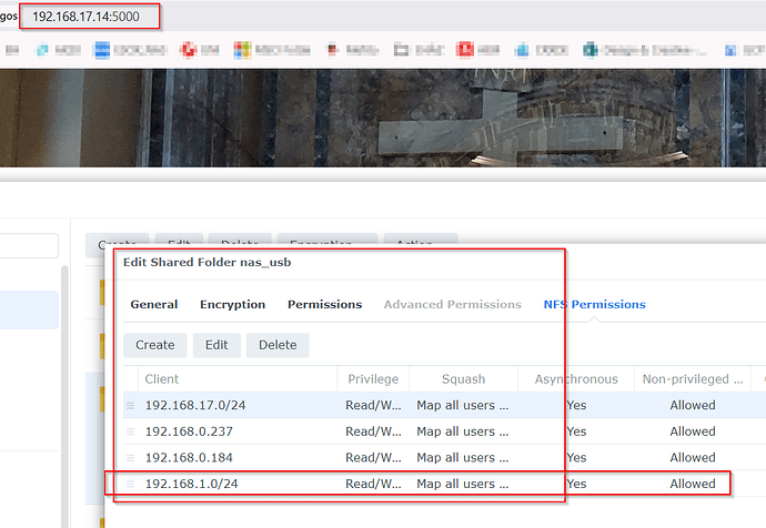

I set up this settings and applied the october update. Since than, all of my nfs share are unaccessable.
I’ll post it to another thread, logs:
https://paste.osmc.tv/elodoreyud
2024-12-03 09:34:13.595 T:3012 error <general>: NFS: Failed to mount nfs share: / (mount_cb: command timed out)
2024-12-03 09:34:13.597 T:3012 warning <general>: Process directory 'nfs://192.168.17.14/volumeUSB1/usbshare/tv series - usb/Severance/' does not exist - skipping scan.
192.168.1.x allowed to access
Please open new thread to not pollute this thread.
But initial question what is sitting between 192.168.1.0/24 and 192.168.17.0/24?
0/24 means every number from 0…255
Really? Wasn’t aware of that
8 bits dedicated to IPs
Which means 2^8 = 255
Two IPs are lost (broadcast address and gateway address), giving 253 usable/routable IPs.
I can do CIDR and calculations for v4 but when it gets to v6 it gets a bit
Try a ping first to check access.
This is definitely did the “trick”. Thank you.
