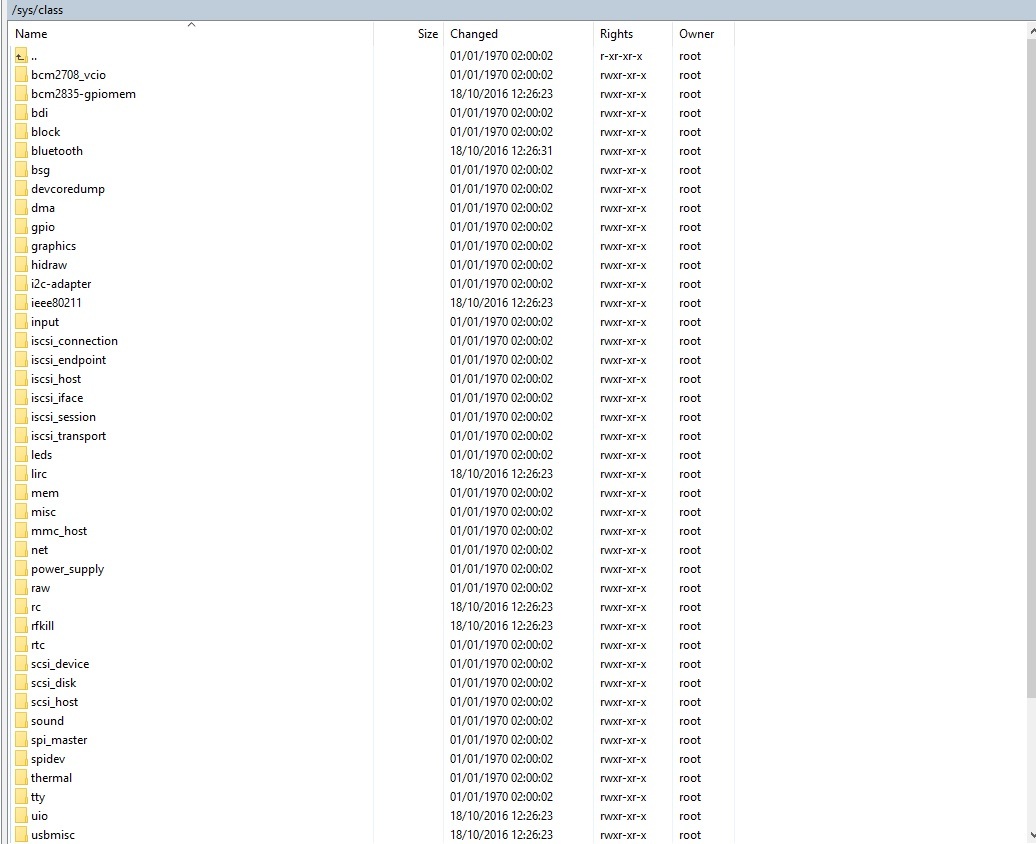

I found this info on the web, but when i go to that path i didn`t find the backlight folder and all the subfolders.
i downloaded/installed the latest version of OSMC from the website. Here is a print Screen of the folders inside sys/class
Thanks!
The most likely reason for the absence of the backlight folder is that your installation doesn’t include the latest RPI firmware. If you update the firmware with:
sudo rpi-update
and then reboot, the missing folders should appear and
echo 1 > /sys/class/backlight/rpi_backlight/bl_power
should immediately switch off the display.
echo 0 > /sys/class/backlight/rpi_backlight/bl_power
will switch it back on again.
You may like to backup your SD card before doing this so that you can revert easily if needed.

I tried to make this changes but i don`t have the folders you mention.
In /usr/lib/systemd/ there is no system-shutdown folder. - so i created the folder and the file with the info you gave me.
I followed your instructions step by step but sadly the result is the same. There is no difference in the shutdown process
