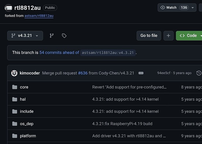

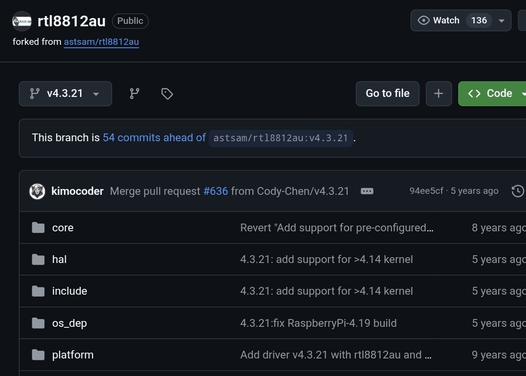

The oldest branch in that driver git appears to be created in 2016 and is based off of the Realtek drivers from then. It does specifically have a mention of supporting “>4.14 kernel”. So I suppose the actual dongle is based off a chipset from 2016 if not older.
From:
Then it’s unlikely to work on 4.2 kernel
Well, “adding support” for 4.14 kernel. I just mean that’s the oldest specific kernel version in the commit summaries I saw. But I don’t know what the oldest supported is.

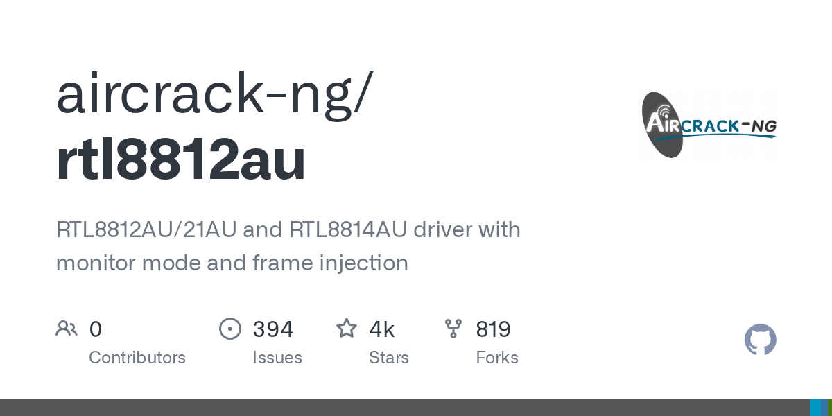

I can’t seem to find any minimum Linux kernel version for the aircrack git:

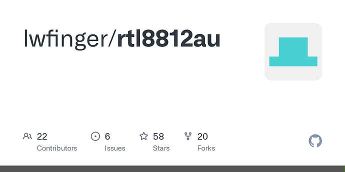

But it appears another fork of the save driver mentions the driver is from 2013 and supports Linux >3.10:
So it seems like it will work if we have the ATV OSMC headers. What would the next step be?
