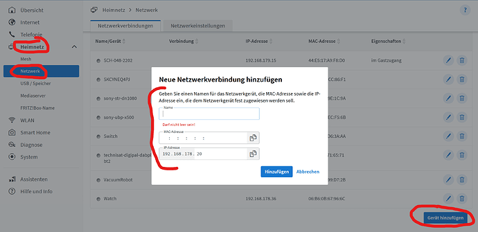

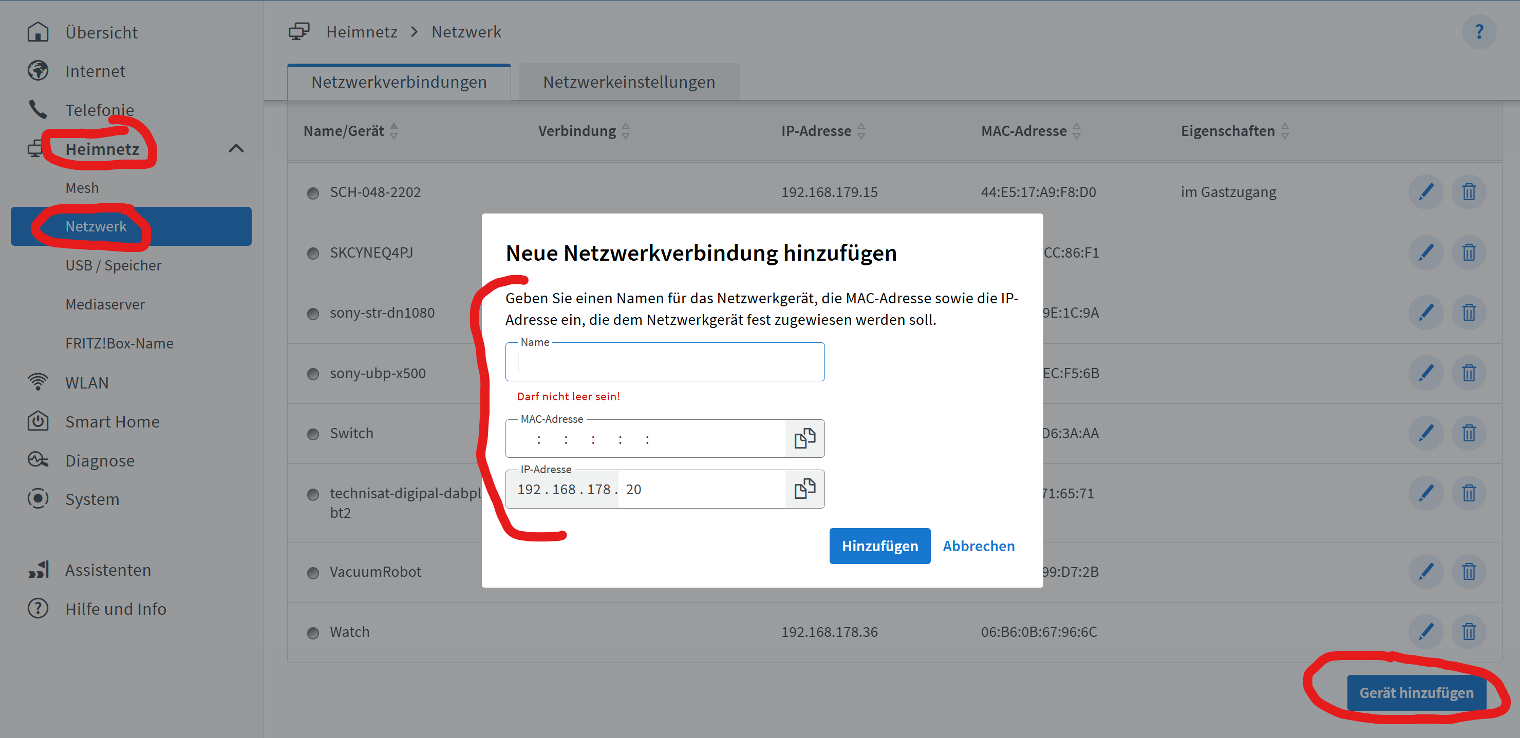

Perhaps, the 6490 requires to know the static ipv4 of the OSMC device
